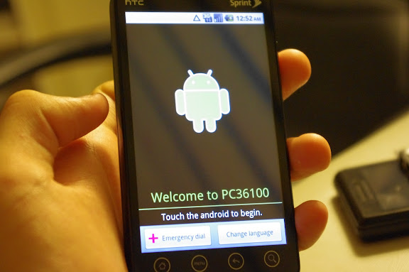

White bootloader screen.
If you see this it means it didn't find the right ZIP file.
Updating!
Root success.
First time seeing this pop up..
Waits here forEVER.
Just like new.
No Superuser app?! Did I do something wrong.
No problem! Didn't even ask for permissions.

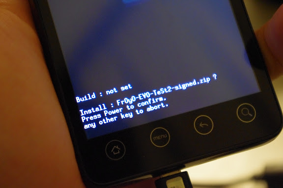

Starting Evo Froyo update!!!

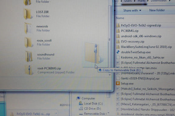

Transfer the update ZIP to SDCARD

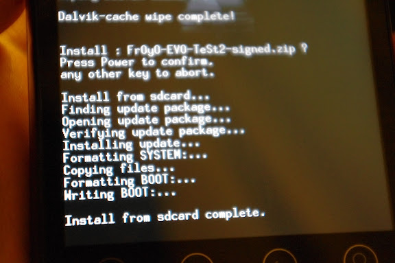

Wipe data and dalvik cache after reboot into recovery. To do this, boot into the bootloader (vol down+power), choose Recovery, connect usb to computer, run recovery-windows.bat

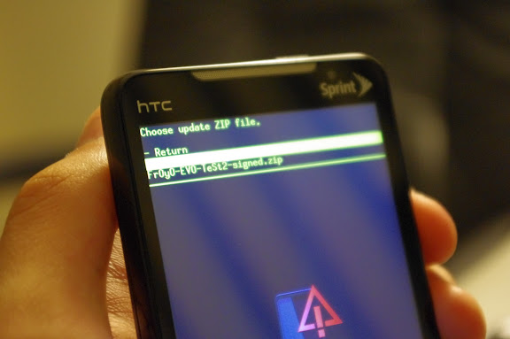

Choose Update from SDCARD
Ahhh so scary!
Success!

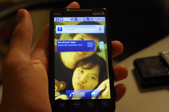

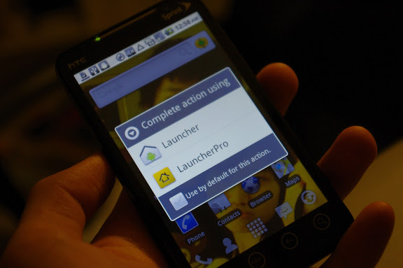

FROYO HOMESCREEN!
What the, it automatically "Restored" my apps. Is Froyo getting smart?

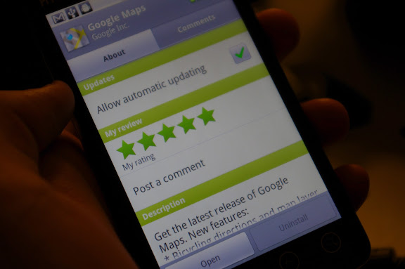

New Market look. Automatic updating!
This is going to make the Market comments much more useful.

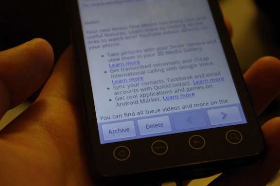

Buttons look different in Gmail.

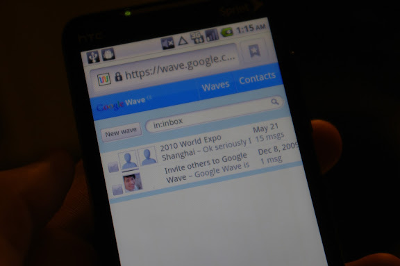

Google Wave is probably the slowest, javascript-heavy site out there. It loads!
I don't remember being able to do this with the past browsers. V8 engine in the new Froyo browser.

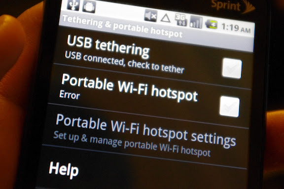

Unable to Wireless Tether

BTW, check and make sure wifi works, then go try the wireless tether for root users, I want to know if it works. http://code.google.com/p/android-wifi-tether/

Sorry can't get it to work. Then again, i couldnt get it to work on my Moto Droid either.

does wifi work?

does wifi work?
yes perfectly
