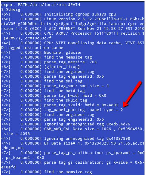

Second method for stock non rooted devices is to install Terminal emulator from the market. Restart your phone and immediately open the Terminal emulator and type "dmesg" without quotes. You will see a lot of data. Just scroll all the way back to the top and look around line 14-15 and you will see a line that ends with Panel Type=1 or Panel Type=2
Panel type 1 is the bad screen and Panel type 2 is the good screen.
Here is a picture of what to look for:
