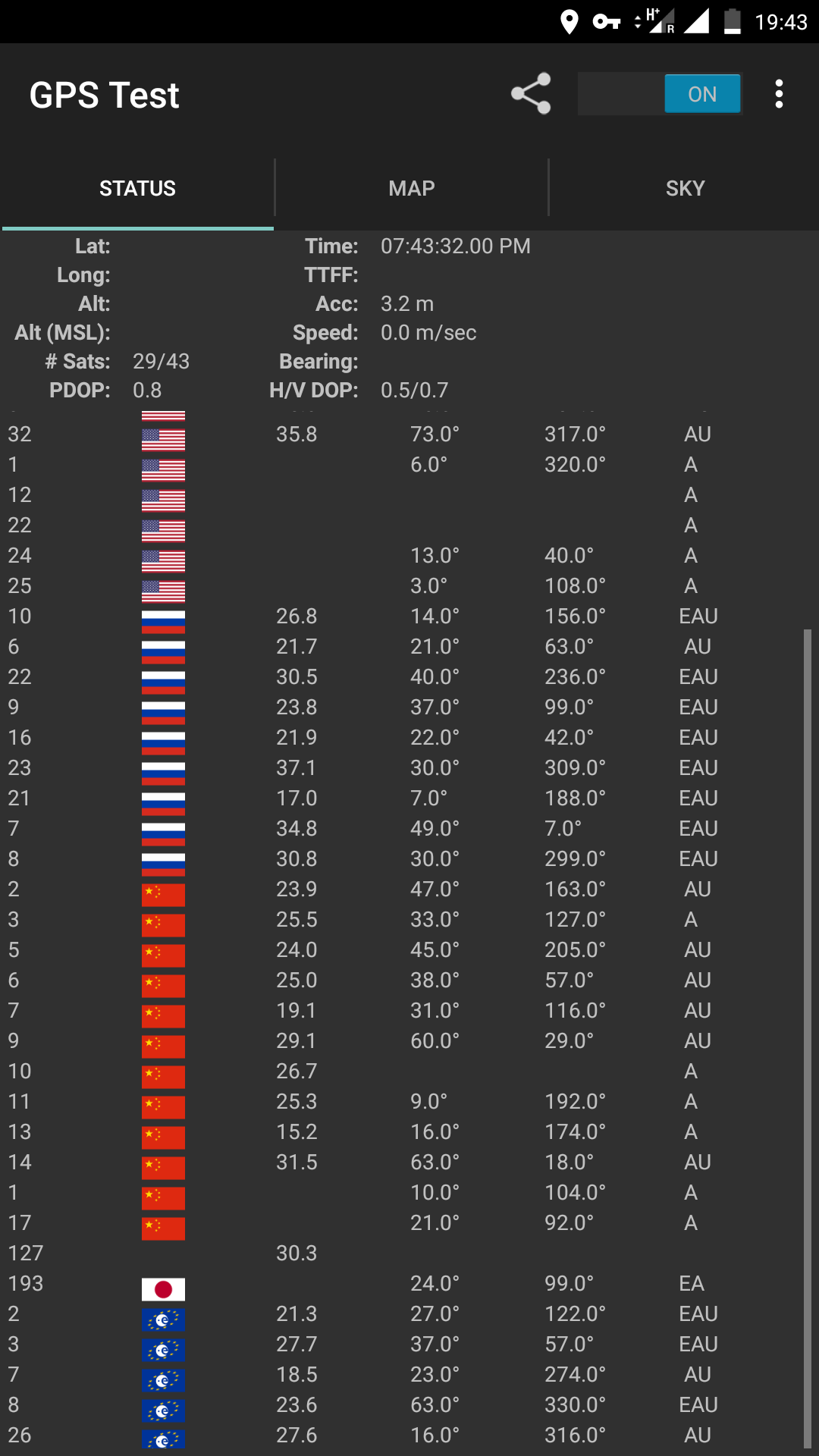

Do you see the Galileo satellites on your Honor 9 phone GPS app ?
All online databases say Honor 9 does not support Galileo reception,
but the XML config file in vendor.img has it enabled
and the hardware (Broadcom BCM4774) is Galileo-capable.
Now i'm confused and want to hear about the experience of the
real phone owners.

Honor 9 has EnableGalileo="true" in /etc/gps4774config.xml
  <gll_features
        EnableLowPowerPmm="true"
        EnableOnChipMiCtrl="true"
        EnableInternalBlanking="true"
I am using the GPS Test app (on Mate 9 with the same gps4774config.xml) and it looks that (obviously i see less chinese satellites in Europe)
https://user-images.githubuserconten...d05ce61429.png
Which program did you use for testing GPS ?
