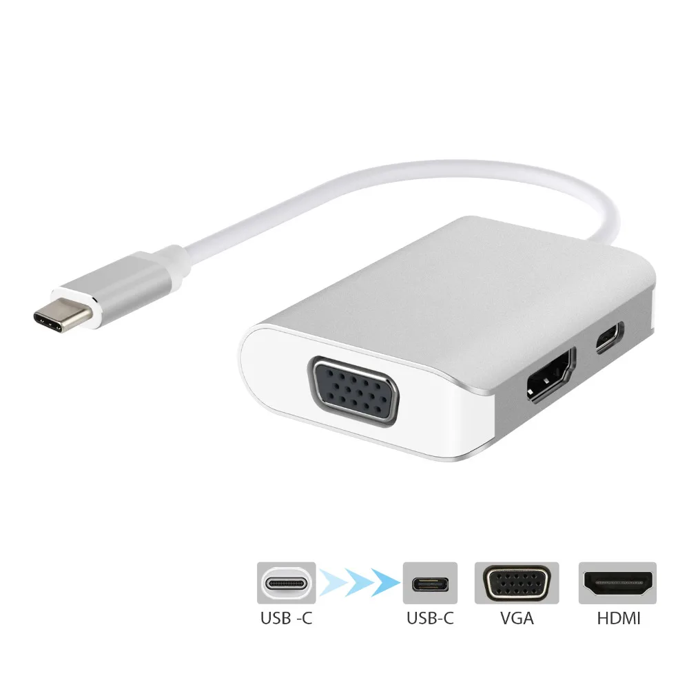

helder_jb
Sep 1, 2010
Hi!
Just to add to the thread: this model from Ali Express works, for both screen mirroring and DeX mode! :D
DZLST-Type-C-3-1-Adapter-USB-C-HUB-Splitter-HDMI-4K-30Hz-VGA-1080P-60Hz
I just need to plug the PD power before connecting the USB-C to my Note 8
There are some other brands that sell the same model, I suppose they also work in DeX mode.
