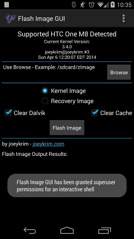

Description:
This android application, FlashImageGUI, is basically a GUI interface for the linux binary, flash_image provided by google in AOSP for loading custom kernels and recovery images onto the phone.
This app allows the flashing of kernels and custom recovery images in normal android mode!

Screenshots:

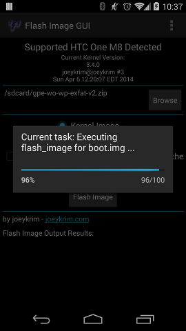

Users Guide for flashing ONLY a Kernel (zip file):
1) Ensure the bootloader is unlocked and root access is properly setup
2) Make sure the selected Kernel is compatible with the currently loaded ROM. If not, this will result in a lot of frustration!!! See troubleshooting steps below.
3) Download kernel zip file to /sdcard.
4) Open Flash Image GUI, browse and select kernel zip file, downloaded/loaded to sdcard in previous step.
5) Flash Image GUI will validate that the kernel zip file contains the minimum required files
6) Select the Flash Image button and Flash Image GUI will load the kernel and the kernel modules from the source kernel zip file.
7) Reboot
