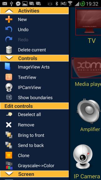

RemoteGate main view

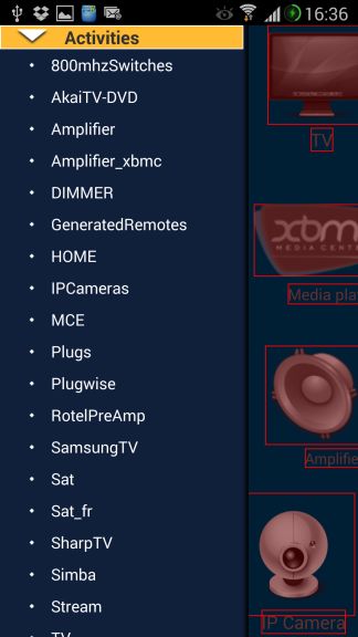

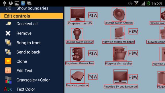

RemoteGate Design screen and menu listing of the activities
RemoteGate Design screen more menu ( controls etc)

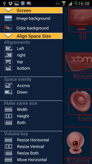

RemoteGate Design screen more menu ( alignment/resizing/moving etc...)

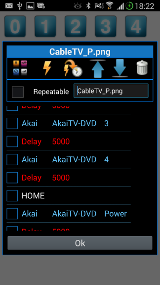

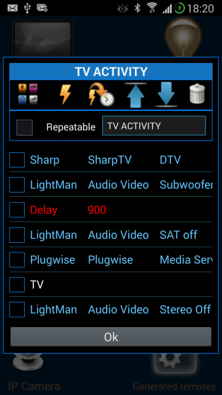

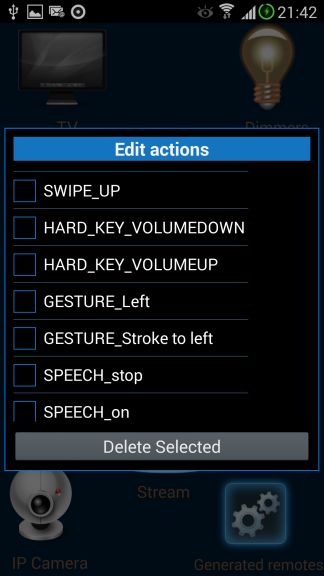

RemoteGate Activity action menu

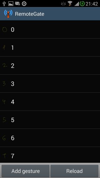

Custom Gesture Edit
Non visual actions edit and view
Non visual actions (speech) go to discovery channel on sharp TV

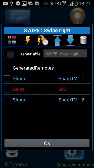

RemoteGate Activity action on gesture IE. Swipe right.

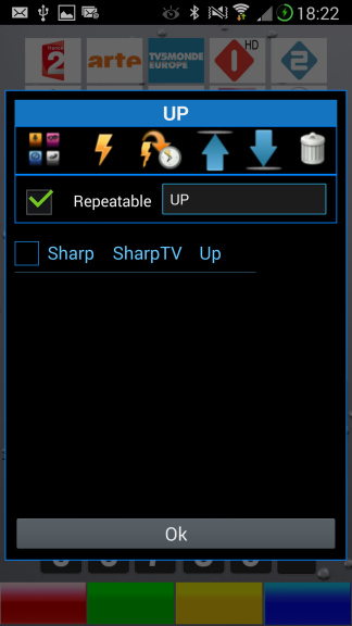

RemoteGate Activity action (bindings) to a button that support repeat ( long touch)

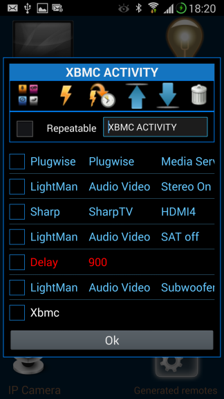

RemoteGate Activity action XBMC / TV and long action test example

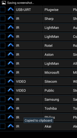

RemoteGate device DB menu
RemoteGate DB supported DEVICES : IR=device internal blaster. VIDEO RTSP stream, USB-UIRT via WIFI RemoteGATE.py SERVER

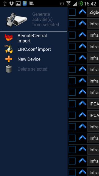

RemoteGate device DB Editing and testing IR
RemoteGate device DB fetching BRAND from RemoteCentrale or LIRC DB
RemoteGate device DB fetching MODEL from RemoteCentrale or LIRC DB
RemoteGate device DB testing fetched code from RemoteCentrale or LIRC DB

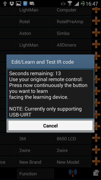

RemoteGate device DB Learning IR from original remote using USB-UIRT and RemoteGATE.py server

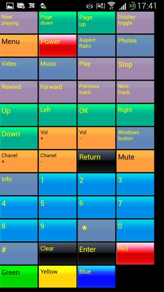

RemoteGate device DB generating remote template from selected devices

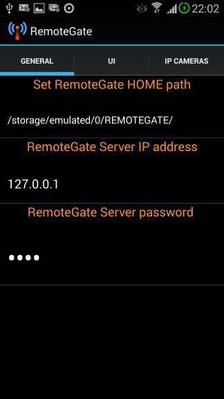

Settings General

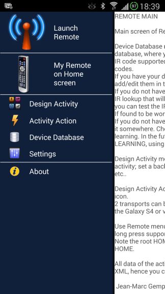

REMOTEGATE USAGE:
SETTINGS
-Not much for the moment, the only important settings are
HOME path : this need to point to the REMOTEGATE folder you unzipped (see install )
Gate IP address : Only use if you use the Python RemoteGATE.py server
LAUNCH REMOTE
-Select Launch Remote from the menu
This will show you my HOME designed activity.
This is the remote I designed for my usage. You can edit or start a new HOME screen from scratch.
The visual objects are stored im the HOME.XML from /REMOTEGATE/ACTIVITY folder.
Touching any of the button will bring you to other activities as well as blasting IR (see activity action)
Touching hard key back button will go back to the HOME screen.

DEVICE DATABASE
This is DEVICES.XML file in /REMOTEGATE that contains all your DEVICE IR CODE or PLUGWISE mac address of plugs ( this require the Python RemoteGATE.py server running. The provided DEVICES.XML is my own DB as an example.
To open the XML DB go to the MAIN main menu and select "Device database"
You can scroll right / left to see the full contents.

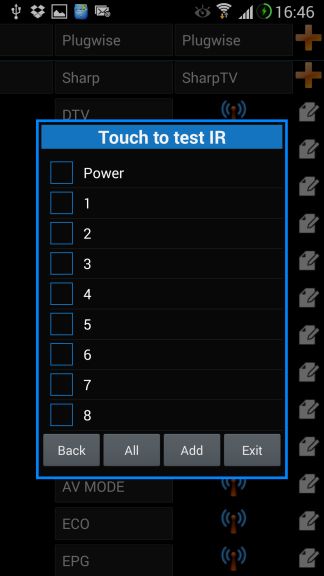

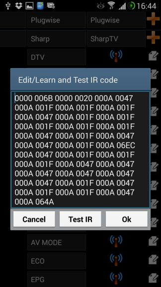

Here in the Device DB you can edit and save your own pronto IR
The Device DB menu allows you to Save/ Delete selected rows but also to lookup a device from the internet ( using REMOTECENTRAL OR LIRC database)
The dialog will go through BRANDS then the model selection
Finally the function of the device. Here you can test IR codes
Once you tested your IR code fine just add them

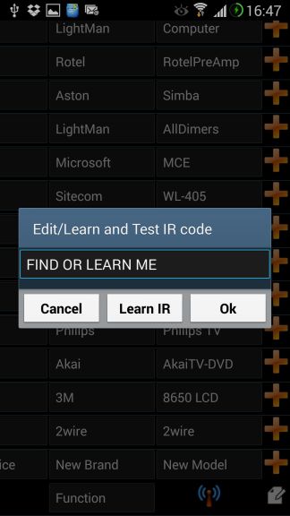

You can also create new devices touching + in the menu. Then from the new device you created, you can touch the + on the row to add new function
At this point either you copy and paste an IR PRONTO code in your new function OR you can use Python RemoteGATE.py server to learn code of your original remote ONLY if you have USB-UIRT. Or set anything you want here, it be sent as a message string to the server to process any kind of action you want if you programmed it on the server.
See VIDEO
"RemoteGate learning remote code via RemoteGate Python socket server with USB-UIRT"

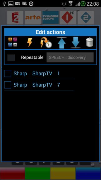

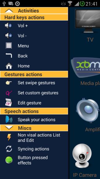

ACTIVITY ACTION
Finally once you have created activities from your DEVICE DB you can BIND your activities button(s)/icon(s) to function(s) from your DEVICE DB or to another activity ( jump to activity).
You can bind and send IR code via NATIVE GS4 IR device or via IP Python RemoteGATE.py server that uses currently only USB-UIRT
The binding is done in REMOTEGATE APP main menu selecting "Activity Actions"

-List of non-visual actions (i.e.: HARD KEY, GESTURE, SPEECH ) in RemoteGate activity action, so you can delete / edit non visual actions.

-RemoteGate Config screen support now
-RemoteGate password

Add Simple Gesture ( swipe up/down/right/left ) in edit activity action so to bind these gesture to list of actions: JUMP to an activity + BLAST + DELAY

-Implemented LONG TOUCH ( repeatable button) in the remote activity action: you can check any button you want to allow repeat. This is working both for IR and USB-UIRT. Currently timings are hard coded but they be soon or later in the config screen. When USING USB-UIRT and this via the internet, it actually works quite fine...there is some latencies but it is workable.
-Implemented DELAY in milliseconds in activity action, to separate IR blast or USB-UIRT wifi blast to set delays in between blasted actions...

IR learning via USB-UIRT

add / remove / pinch zoom / alignment / sizing / rotation / cloning for ImageView/TextView/VideoView objects

Auto generate remote Activity template from Device Database that can be re-designed if wished in the design activity
-Fully customizable activity actions
Add/remove bindings to designed remote activity objects
Bind ImageView (buttons) to one or more Device database function IR or WIFI
https://www.dropbox.com/s/up7by7jk4bp2kbf/NOTE 2 LEARNING .avi
Custom Gesture Edit

REMOTEGATE USAGE:
SETTINGS

DESIGN ACTIVITY
-You can create ACTIVITIES as much as you want, designing your own screen with your own picture for the remote button.
To do this from the main menu select "Design Activity"
Here you can create a NEW or OPEN an existing ACTIVITY.
Then you can add a new control(s) , you can set a background, delete controls etc...
As an example adding a new IMAGEVIEW control will look at the provide folder /REMOTEGATE/BUTTONS
This is a folder containing ICONS/PICTURE, you can use your own .
It will exposes icons and here you can multi-select to add to your activity
When selecting, the button(s) they will show on the activity and you can then pinch zoom to move position it in your activity
You can further align the button(s) etc.. to design you own remote activity.
Once finish with the design touch BACK hard button.
This will update or SAVE your new activity in the /REMOTEGATE/ACTIVITY folder as the NAME.XML you gave when you saved the activity...

DEVICE DATABASE
See VIDEO
ACTIVITY ACTION
All buttons without action(s) will show in purple gray
Open an existing activity and click the button. If there are already binding(s) you can see the list to update it or delete it.
If there isn't binding(s) you can add actions in a list to accomplish multiple actions ( IR or WIFI ) to be blasted when touching the button when the remote got launched. SEE the TV, MEDIA PLAYER, Satellite actions as a example.

-Custom gesture now GLOBAL or LOCAL to an activity screen. Allowing specific gesture per remote screen (avoiding conflicts with other one )

-Custom gesture support for remote actions ( works also on Galaxy ACE)
-Speech recognition for remote action ( not supported on Galaxy ACE, OK on Note 2, TAB 7.7).
To make this feature work make sure in Language and Input settings you select Google Voice typing and choose your language and for offline speech recognition download you language

-Generate remote template from the DEVICE database
