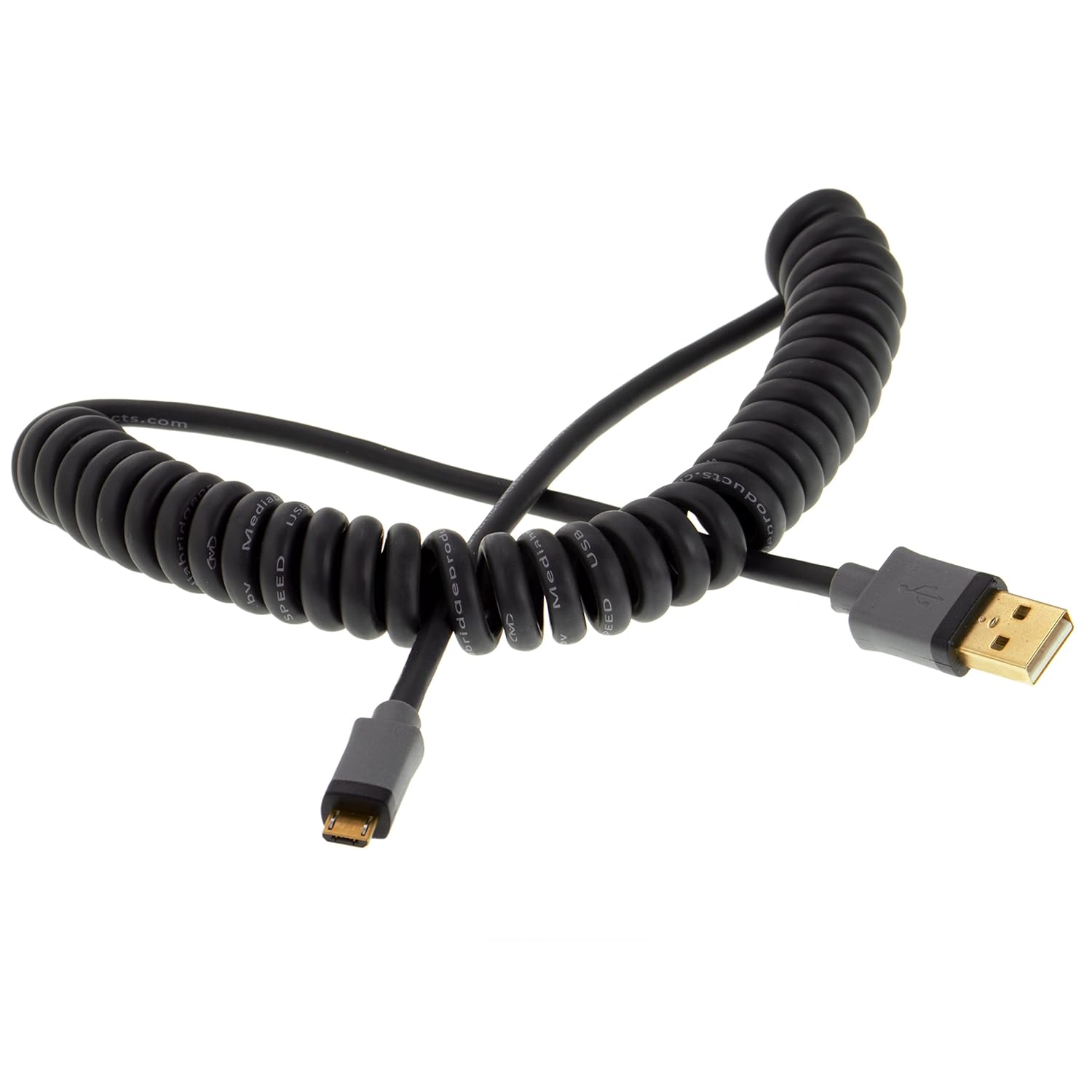

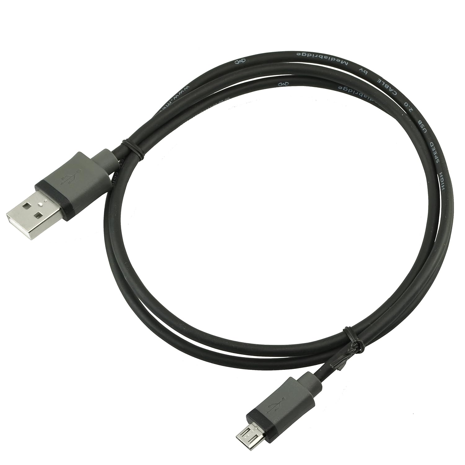

For those interested in the MediaBridge USB cables, here you go... I actually just went back and wrote an Amazon 5-star review of these cables due to testing with this app.
Here's 6ft at Amazon. Also other lengths are available.
Mediabridge USB 2.0 - Micro-USB to USB Cable
https://www.amazon.com/Mediabridge-...=Mediabridge+USB+2.0+-+Micro-USB+to+USB+Cable
For my car charger, I use this since it's coiled and can stretch to what I need:
Mediabridge USB 2.0 - Micro-USB to USB Coiled Cable (1-3 Feet) - High-Speed A Male to Micro B with Gold-Plated Connectors
