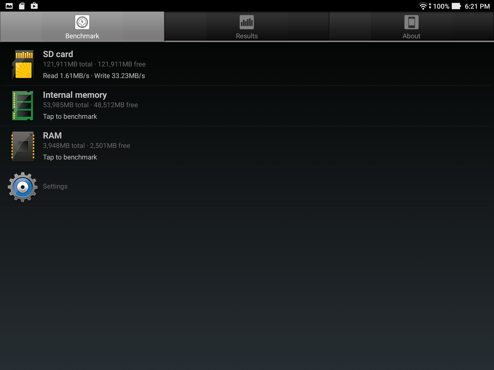

Anyone try an SD card greater than 32GB in their Asus 3s 10 Z500M? I've tried three, and they all get read speeds of only 1.8MB/s, which is insufficient for any video streaming without glitching. That's 10% of what I observe in other tablets and on my pc. If you have an SDXC card, please let us know what your read-performance is in the "A1 SD Bench" app. (write speeds are just fine at 20MB/s btw).
(SDHC cards <=32GB work just fine)
I've got 128GB SDXC and can run 1080p video off of just fine. But I haven't run any benchtest app
edfardos
May 7, 2013
15
Yah, they kinda work, you start noticing it after you FF or RR a bit, it can glitch. GoPro video is the worst since they aren't compressed very well. Reading files back to your PC via the Zenpad also show 2MB/s.
In any event an "A1 SD Bench" read-benchmark is the only way to be sure. If you have a working card (10-20MB/s), perhaps you could share the make/model.
My Z500M "A1 SD Bench" score with Samsung Evo+ 128GB SDXC (same for sandisk microSD 128GB SDXC):
http://sierraglider.com/craiger/slow_screenshot.jpg
r,
-edfardos

I loaded up the app and ran the benchmark. I have a SanDisk SL128 128 GB card and scored a whopping 4.42 MB/s Read and 32.99MB/s Write. Guess I'll just have to suffer with a few video glitches here and there.
Whoa! you got 4MB/s on an SDXC card! I think that was my highest reading ever. I suspect if you run the test a few more times you'll see it average at 2MB/s. These SDXC cards are 10 times faster in other devices and PC's. I'll stick with the old SDHC technology (32GB max) until asus can possibly fix this in a firmware update. I logged a support call with them, but, to be honest, I'm less than hopeful any information will get through to anyone who can help.
This is still a spectacular tablet imho. Fix the SDXC read speeds, move the speakers to the long-side, and it'd be *perfect*. Better value than anything samsung or google can provide imho.
--edfardos
I have the update and get 17.53 read and 30.33 write on my external 64gb SD card
Sent from my P027
edfardos
May 7, 2013
15
Sent from my P027
That's full speed! Perhaps only 128GB cards are problematic?
Would you mind sharing the exact make and model of your 64GB card that's getting 17.53MB/s?
Also, you can see other's p027 "A1 SD Bench" results here: http://a1dev.com/sd-bench/results/your-model/#results
radon222: I just spotted yours.
loner: You appear to have tested your *internal* SD card, could you confirm? (it's yellow fwiw). I see a test with 17.53MB/read, on the *internal* card at that link, so I'm just assuming that's your test
Sent from my P027
