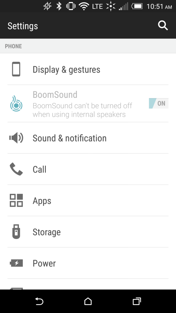

This is what BoomSound looks like in Settings:

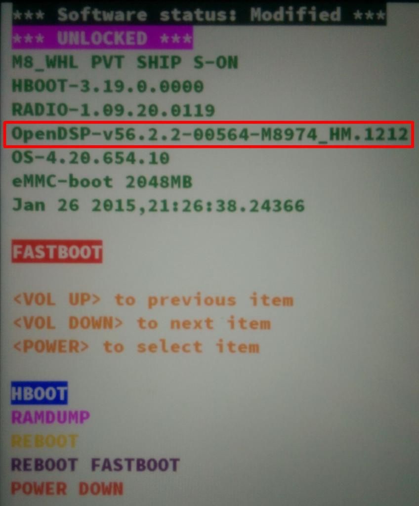

The adsp version can be found in the bootloader (HBOOT). The current BoomSound adsp information can be found below:

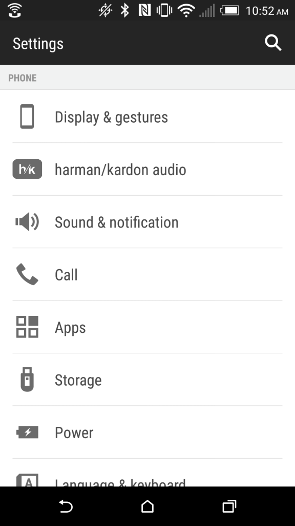

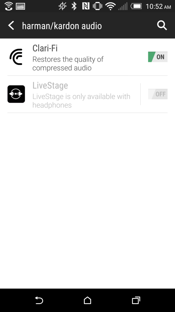

This is what Harman Kardon looks like in Settings:

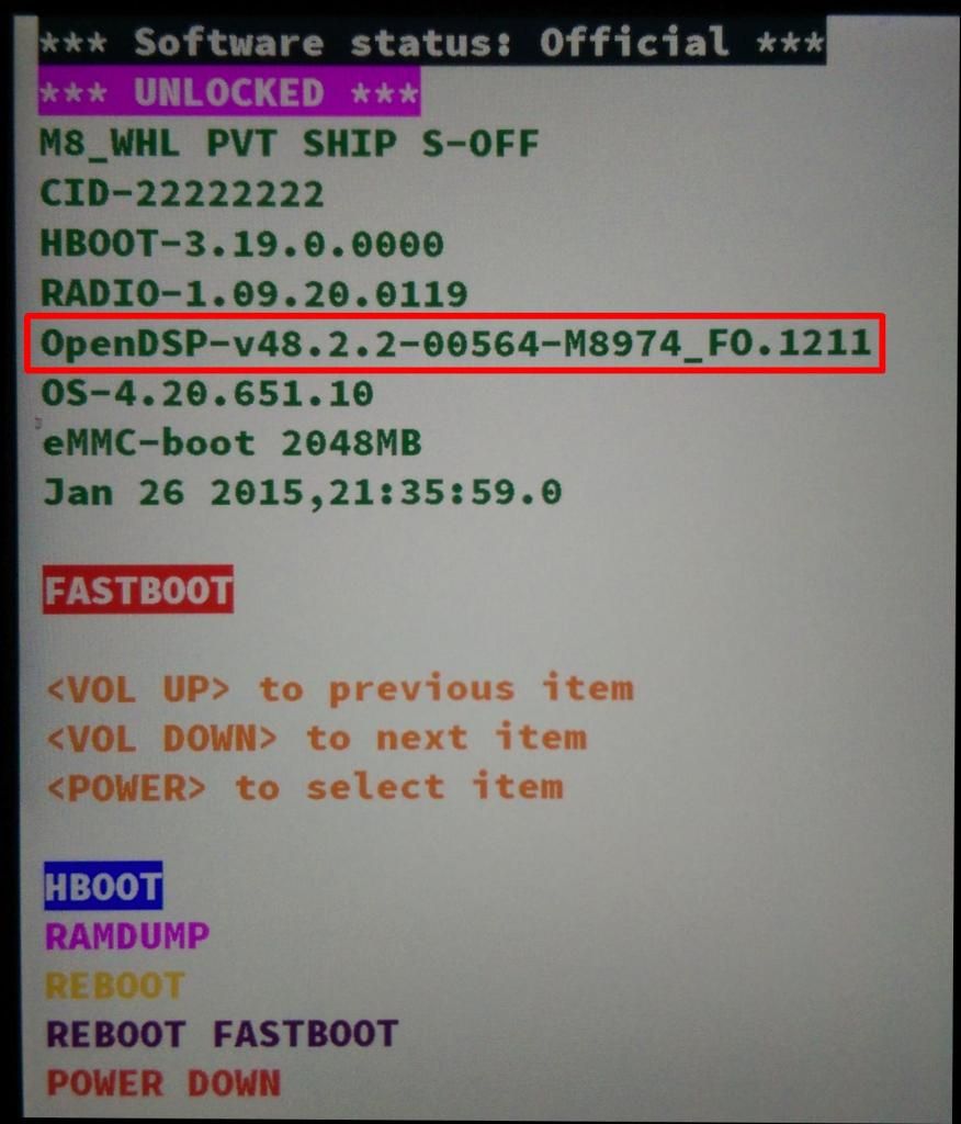

The current Harman Kardon Edition adsp information can be found below:

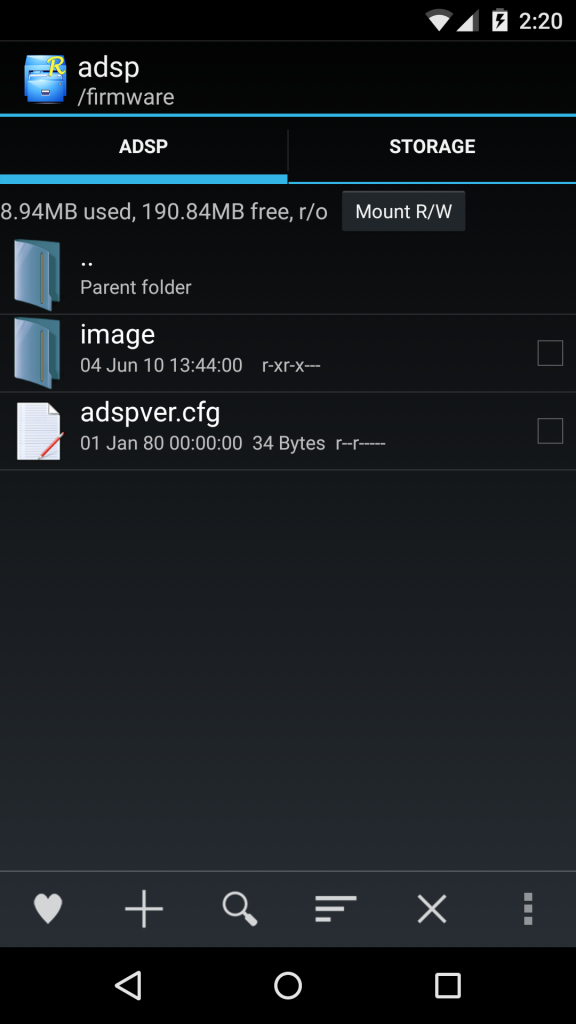

NOTE: The adsp version can also be found in /firmware/adsp in the file adspver.cfg. See below:

The current 4.1.0 version is supposed to fix the not showing HK entries in Settings.
This has had some users affected with different CID's which i call exotic because i haven't seen many of them.
One report i remember is HTC__J15 (HTC-GCC) Middle East, which seems to somehow be using a carrier specific default.xml.
This is what @EarlyMon's shell script is addressing.
We would like to know if it worked. Short report of a stock HTC__J15 phone will probably suffice.

@Sneakyghost Hey I attached my install log, was wondering if you could look at it and let me know if you think the install was successful, not sure how to interpret some of it. Thanks so much
https://docs.google.com/file/d/0B4AuVacvrEMCaHY1ZHZxbjQ2dzA/edit?usp=docslist_api
Wouldn't it just be easier to just check your adsp version in HBOOT and your Settings for HK? That's the surefire way to know if it worked. The log doesn't necessary provide enough information to determine that. But if your adsp is updated, the Settings are there, and audio works, what additional evidence/reassurance do you need?
Reactions: H4xz3n
H4xz3n
Mar 3, 2012
184
41
Calgary, Alberta
It shows v56.2.2-00564-M8974_HM.1212, is that the correct one?
Edit: nevermind I found it in the open post I am just being silly thanks for the help mod is working thank you so much
