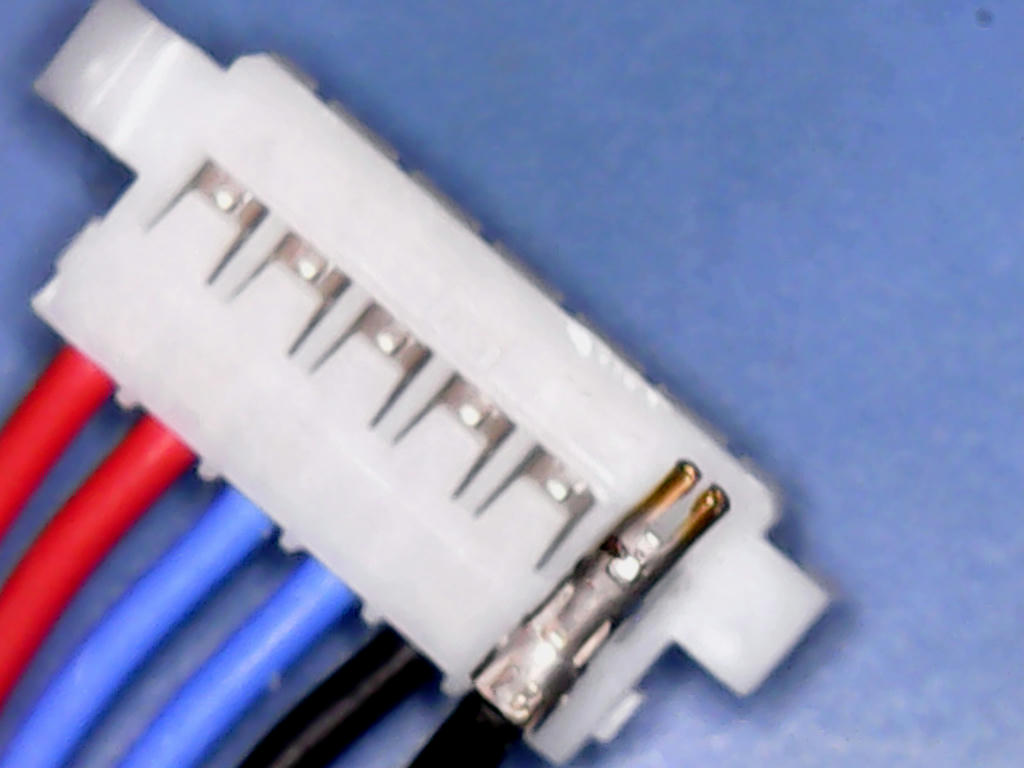

Common problem of Galaxy Note and Tab Pro: cracked battery connector. Resolder battery connector will fix : quick discharge, long charge time, not fully charged, battery capacity fluctuation....etc...
This black battery connector was re soldered already to fix this problem:
As seen in above picture, battery cables are not fully contact with pins of male battery connector also are the source of problem.

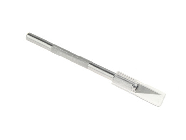

The fix is simple: pushing the opening closer, you need a magnified glass and thin knife to do this:
After the fix, this is a good connection between male and female battery connector:
