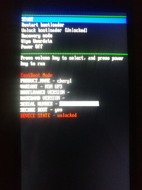

This is what my bootloader shows. Besides the serial number I blocked out, notice how some data is missing? Could this be the problem?
I'm curious to know the method of root everyone else having this problem had used and whether their bootloader looks like this.
