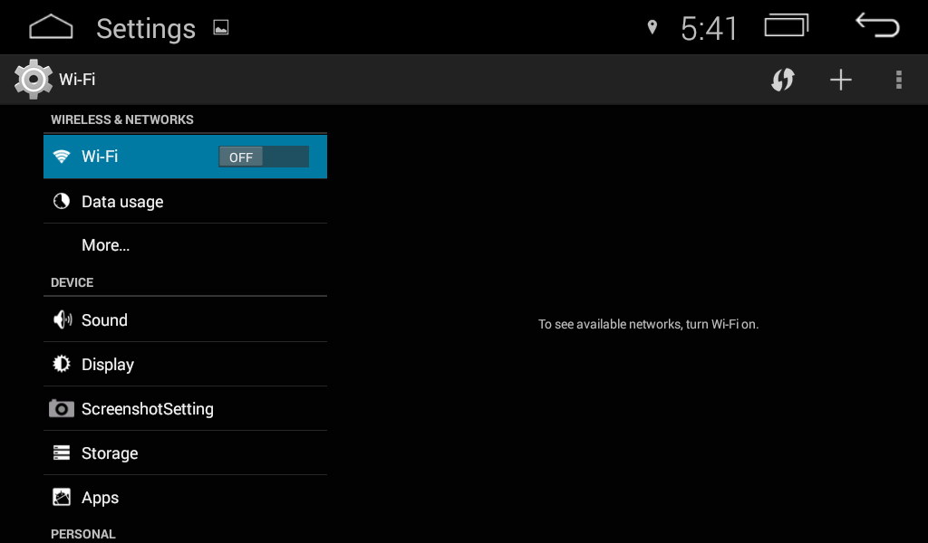

Try to find Bluetooth in the settings application. Please note that the settings application appears in the language you set. E.g. if you set German the app will appear as 'Einstellungen'.
I don't have the bluetooth option in the settings. My settings look like this.
My settings
My settings
This is exactly this unit, only the older edition with 1GB of RAM and android 4.44. I already had it mounted in the car when I bought the car as used.
