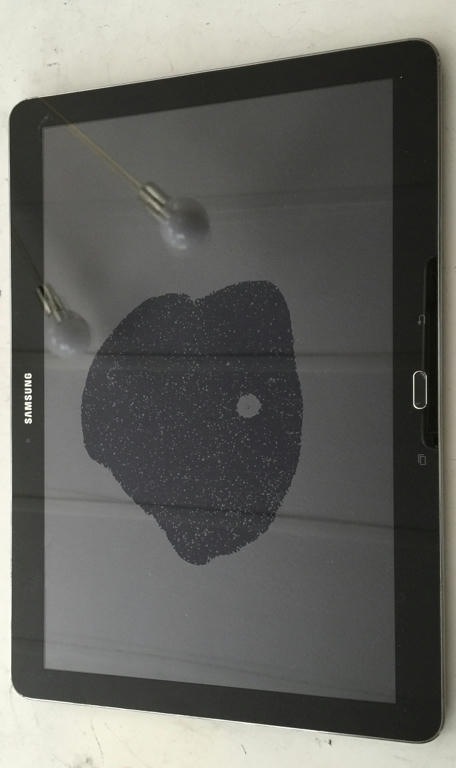

Not recommended if you are first time to do it. Your chance of damaging the LCD is 90%, I damaged at least 2 LCDs and one touchscreen in order to learn how to separate the touchscreen from LCD without causing damages to both of them. It requires experiences and patience, if the screen just have a hairline crack, don't bother to change the touchscreen, use a tempered glass to cover the crack and use the LCD the way it is.
It may take you at least one hour to remove the touchscreen and another hour to clean this glue.
In this picture, the glue is pushed to the center, but before that I had to turn on the tablet to make sure the LCD is not cracked.
The LCD flex cables are the bottom, left side of HOME button, without prior experience they will be cut off easily or damaged.
Then turning off by disconnecting battery because there is no touchscreen.
Without LOCA , the touchscreen will touch the LCD surface somewhere in the center making black spots.
