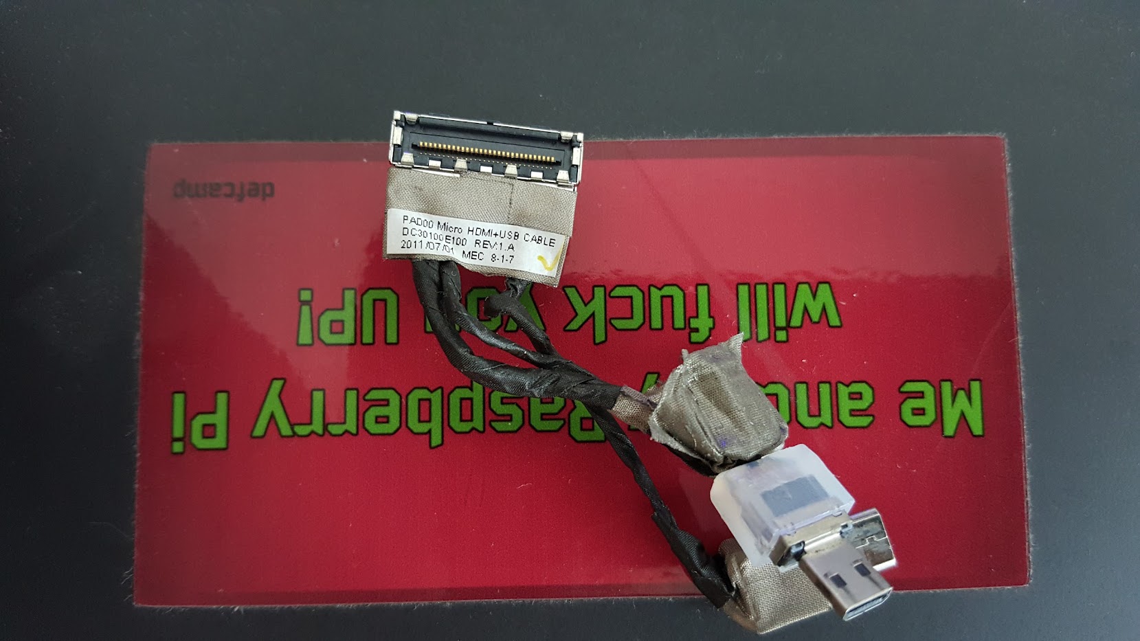

I got a Motorola Lapdock for use with my raspberry pi B+2 the new 1gb quad core version. from CEX not knowing that it has the problem
someone has opened it up and cut the hdmi cable. its too small for me to re-solder it so does anyone know of where I can get a replacement from.
has the following information on it
PAD00 Micro HDMI+USB CABLE
DC30100E100 REV:1.0
2011/04/28 MEC 8-2-1

I have all the external cables I need for the job.
It's the internal Hdmi and micro usb cable that connects to the main board and then has the cable to the two micro plugs you find at the back of the Atrix lapdock.

Sorry for reviving old threads .. I'm in a similar jar .. I've broke mine ! Having the cable on/off .. moving it all over the place .. acted live a "lever" and it seems it broke !
Attaced pics !
