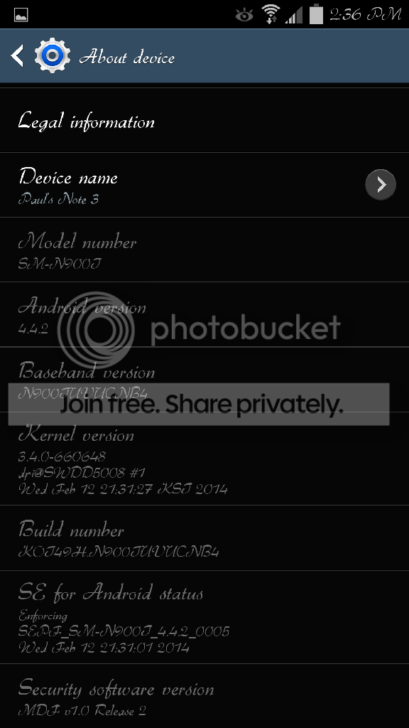

Thanks for the guide, made reference easy. Everything it 100% just like a brand new phone out of the box. I have customized to my liking and am enjoying kk. So far my experience is better battery, and much better signal. Thanks again for taking the time to put everything necessary in one place. Only thing I would add to the guide is to do a full system wipe and factory reset before doing any of these steps.
