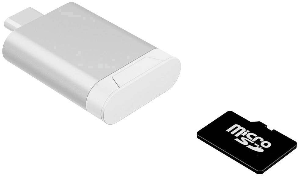

Guide for Dload Method
Instructions for the dload Method
You need NM Card or OTG Stick Typ C
or Adapter Cable Typ C to USB A and USB Stick
At least 30% Battery Level!

For what reason you need this stick? As I know, we need otg cable + any usb 2.0 flash drive. Or you prefer microsd card?
