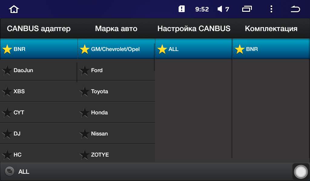

    thanks for your reply. i will explain my problem in order u to understand. i got this android unit SPRD Ums512_1h10_natv for my chevrolet captiva. the only problem is that i cant control my Air conditioning because the canbus doesnt find "captiva" , only chevrolet, in the settings. u think this firmware will do the job? i attach photos . Help pls. Thanks
    Fortunately I do not need Canbus for my car to work so I am not sure. You can try software update or try to choose different canbus settings. You can fnd more here for your car. I know it is not a Teyes unit, but it might help.
