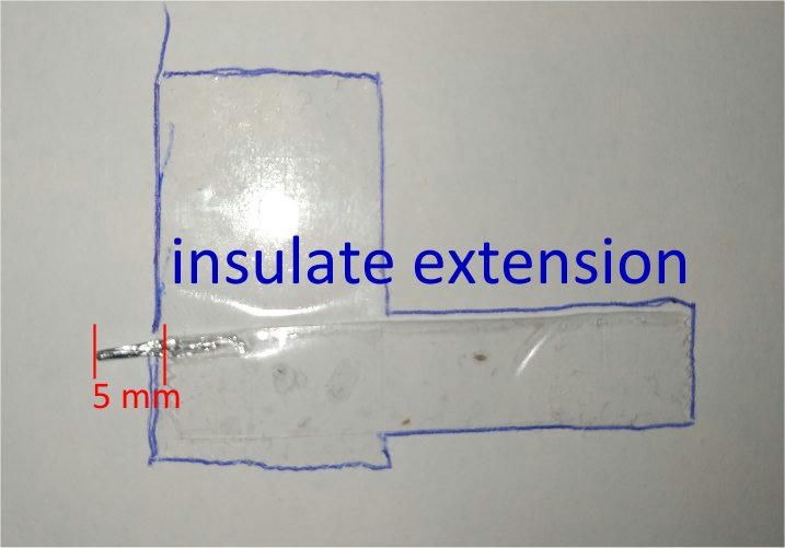

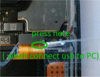

Hi , here's how i managed to start edl on my bricked Poco X3
- The true points are hidden by the usb map , and NOT at the place mentionned in many "putaclic" web pages.
- This place make it really harder to connect than in other know devices.
- Here is my solution :
01 remove cover ..
now remove green screws on the top+orange screw in order to remove plastic cover and access mother board.
02 unplug power map (in red) + usb map (in green)
03 now you see test points (in green) and fakes ones (in red)
04 make a tool using aluminium or coper paper and adhesive
05 place the tool in order to contact points like this :
06 reconnect usb map
you will have to press with your favorite nail to get edl start
Thx and Credits:
@mahajant99 (XDA and telegram) for found the points
Myself for the tool and method without remove mother board
