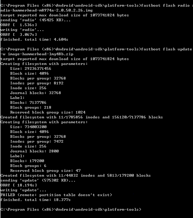

I have nexus 5 when I flashed lollipop 5.0 the phone stock on boot loop and never pass I used fast boot manually flashed /cmd/ So I downgrade to kitkat 4.4 and right now I have unknown baseband no imei no signal,, camera stopped working, play store stopped working, hangouts stopped working,, I flashed too many times the stock Google images without any luck and I did factory reset, wipe cache partition but same issue still I believe the problem it's on the internal storage,, So I don't know What I have to do,, should I format the internal storage ???? please anybody here who can help me and guide me step by step What should I have to do I will appreciate and thank you

sorry did you check the pics which i posted already : which it says :
C:\android-sdk\platform-tools>adb shell
~ # e2fsck /dev/block/platform/msm_sdcc.1/by-name/persist
e2fsck 1.41.14 (22-Dec-2010)
Superblock has an invalid journal (inode 8).
Clear<y>?
so should i hit enter on cmd ???? any help i will be appreciated and thanks
