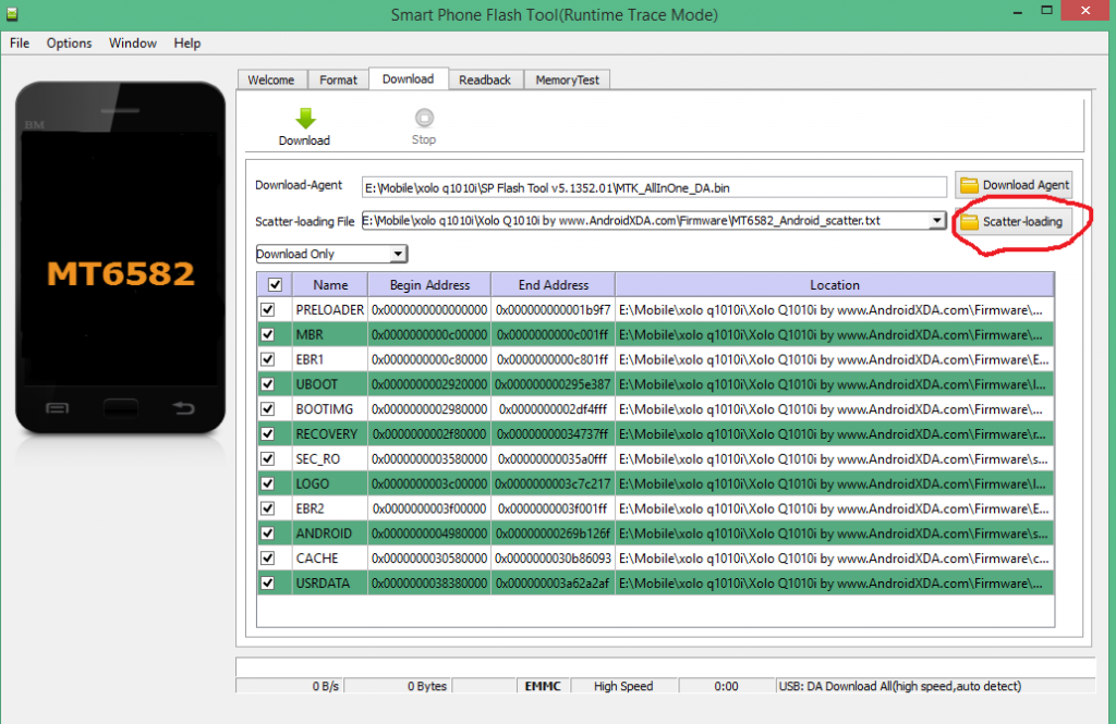

--> Click on scatter Loading.

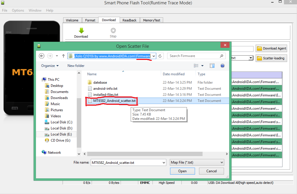

--> choose the MT6582_Android_scatter.txt file in the folder Firmware ( ROM extracted path)

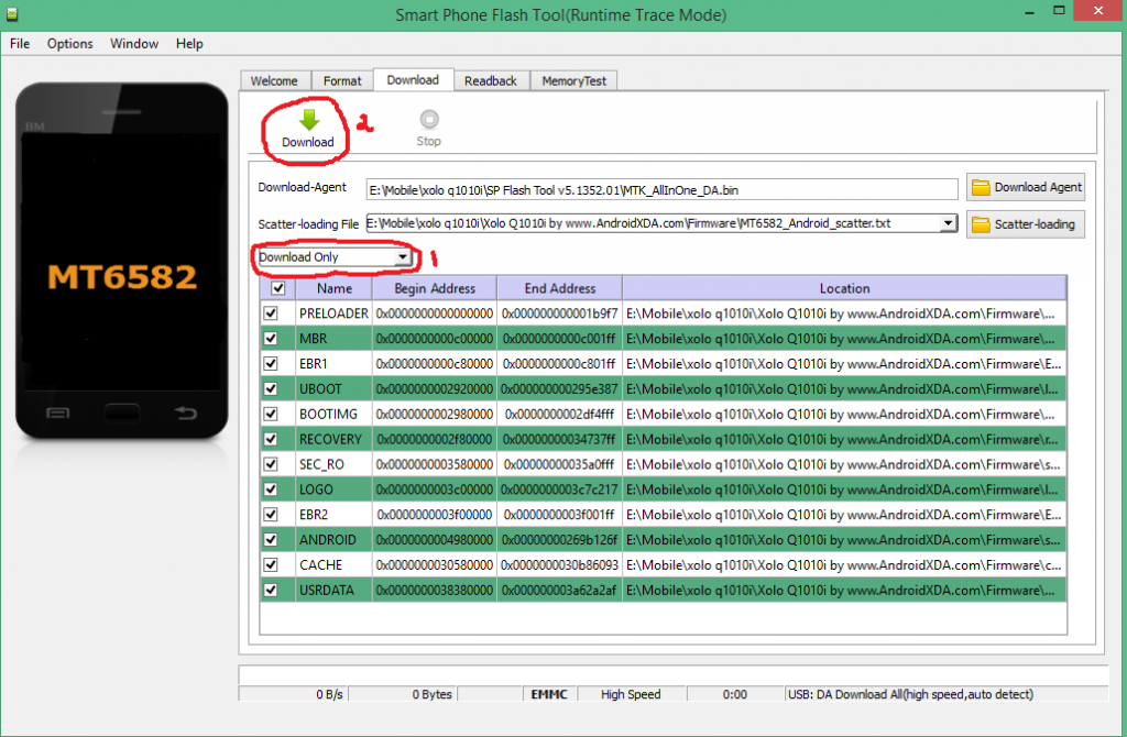

--> Choose Download Only from drop Down and click on DOWNLOAD. (*If it show any error, select Firmware Upgrade from dropdown list and click on DOWNLOAD)
It will load and COMPLETE POPUP will come. The Unplug the phone from PC and turn it ON.
DONE Flashing.
DONE Flashing.
