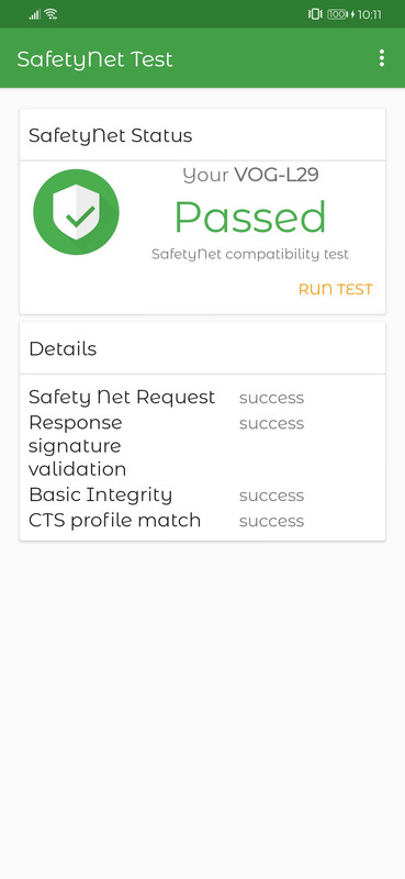

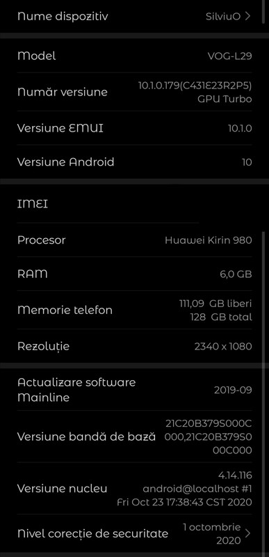

SilviuO
Oct 12, 2013
4,142
5,541
263
37
Bucharest
forum.xda-developers.com
VOG-LGRP2-OVS 10.1.0.179 approved + Safety Net Pass for C431&C432
Hy there,
Just taking a break from my work & meetings to let you guys know that i have updated OP with link for VOG-L09 C431 (needs testing), VOG-L29 C431 & VOG-L29 C432 for v10.1.0.179. No need to flash again CUST, only Base Package ;). Info and SS bellow :)
ONLY FOR VOG-L09 C431 (needs testing), VOG-L29 C431 & VOG-L29 C432 (SAFETY NET PASSES)use as bellow:
ON Package URL copy following link (open link in browser and then copy URL) – http://update.dbankcdn.com/TDS/data/files/p3/s15/G5731/g1755/v480125/f1/full/changelog_base.xml
ON Point Version you have to thick it and write : VOG-LGRP2-OVS 10.1.0.179
Good luck flashing,
