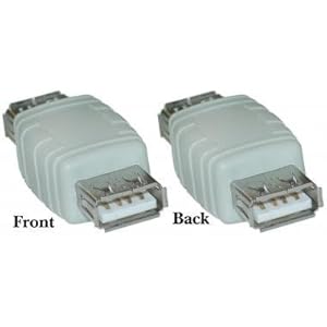

A USB coupler? I have the adapter, thats not the problem. The problem is I keep getting permission errors and what not. Read my post a few posts back to see what i am talking about.

the coupler is for people that cant find the conversion cable...
Tried that, won't work.
You need a cable made for it. Pins 4 and 5 (ID and Ground) need to be shorted, otherwise the Xoom won't know that it's a host device.
You need to DIY it or order it from eBay. As soon as I find some in the US, I'll start shipping them.
