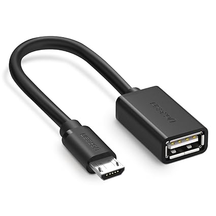

This version of twrp is a work in progress so the touchscreen does not work (this is currently being worked on by the folks at twrp builder https://twrpbuilder.github.io/. As soon as they fix it, I will update this guide!). A temporary fix is by using an OTG Cable https://images-na.ssl-images-amazon.com/images/I/51HI4XhstKL._SX425_.jpg and a standard USB mouse. Use it to swipe-right and select "Install". You might need to "Select storage" and choose your SD card. Find the Magisk zip and install it, then reboot.​
