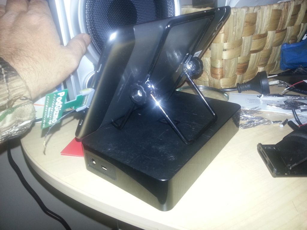

I started with my Kinetica Break out Board (Google it if you want to buy one,about $15 when i got mine)
I stuffed it last year experimenting and burned out a earth of pin 01 but just soldered a wire to the top and all good now
(ignore the black earth wire when looking at my pics,your black wire should go to pin 01 of board).
*instead of using a female usb port for host i use a USB MINI MALE Plug that can go directly to a HDD or Powered HUB.By soldering this directly to the Break out Board it eliminates bad connections and annoying drop outs whilst watching movies from your USB HDD.
This is how it's wired.

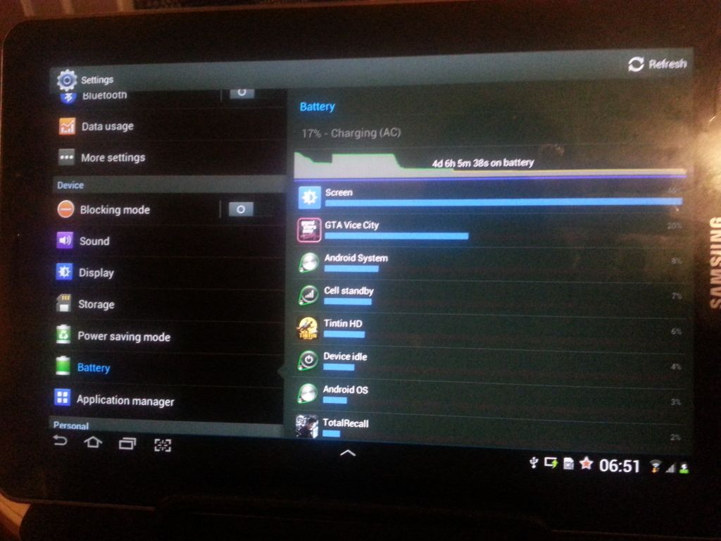

If you got a Red X over your battery Its NOT charging and you shouldnt see one.You need to restart the tab again and need to get rid of the red x properly before going further.
To Get Rid of Red X is tricky sometimes and can be a pain and give you one every time but sometimes it just starts with out one.you need to be patient and just figure out the right time to connect the hdd on start up.when it works remember exactley when you did it and do the same next time.eg count samsung logo flashing etc..then connect it.a bit of experimenting is required here.
Restart the tab with power added and hdd powered but no usb connected.this time put usb in as samsung logo apears.delaying plugging in the hdd seems to work for me and next time it starts you should see its charging on lock screen.
at bottom Right hand corner you will also see a usb symbal and get a message usb device connected.
Now you must check settings/Battery status to see its "AC Charging".
If not another restart will be required untill you get AC Charging.Remember no .5amp 5v sources these may give usb charging instead of AC Charging..

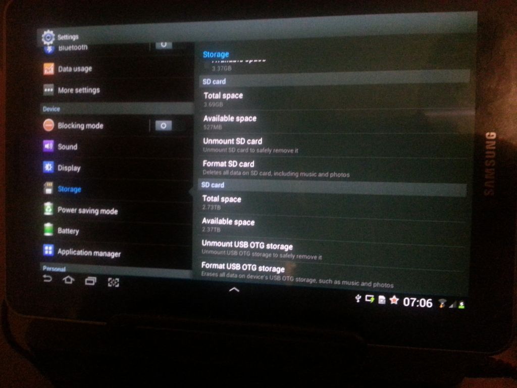

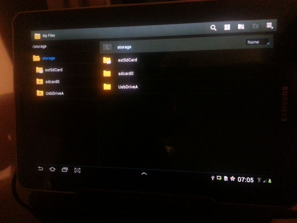

Now open paragon or what ever you use and mount your drive where you want it im doing mine automatically as recomended and seems to work good with the new Stock JB 4.12 rom....
this pic you can see the hdd is mounted in my files
Hdd Sizes..
im using a 3TB NTFS on this pics and works fine.Have also tryed 2TB,1TB,500GB and all work fine inc multiple drives at same time with powered hub.

I wanted to clean it up abit so dug out one of my old USB Host adapters and opened up the plastic case and removed circiut board.
now glued the kinetica board to the case after checking it all works..
glue drying all day before a i close the case but will look a bit neater than wires and stuff everywhere.
I like this better than the dock i did before..
