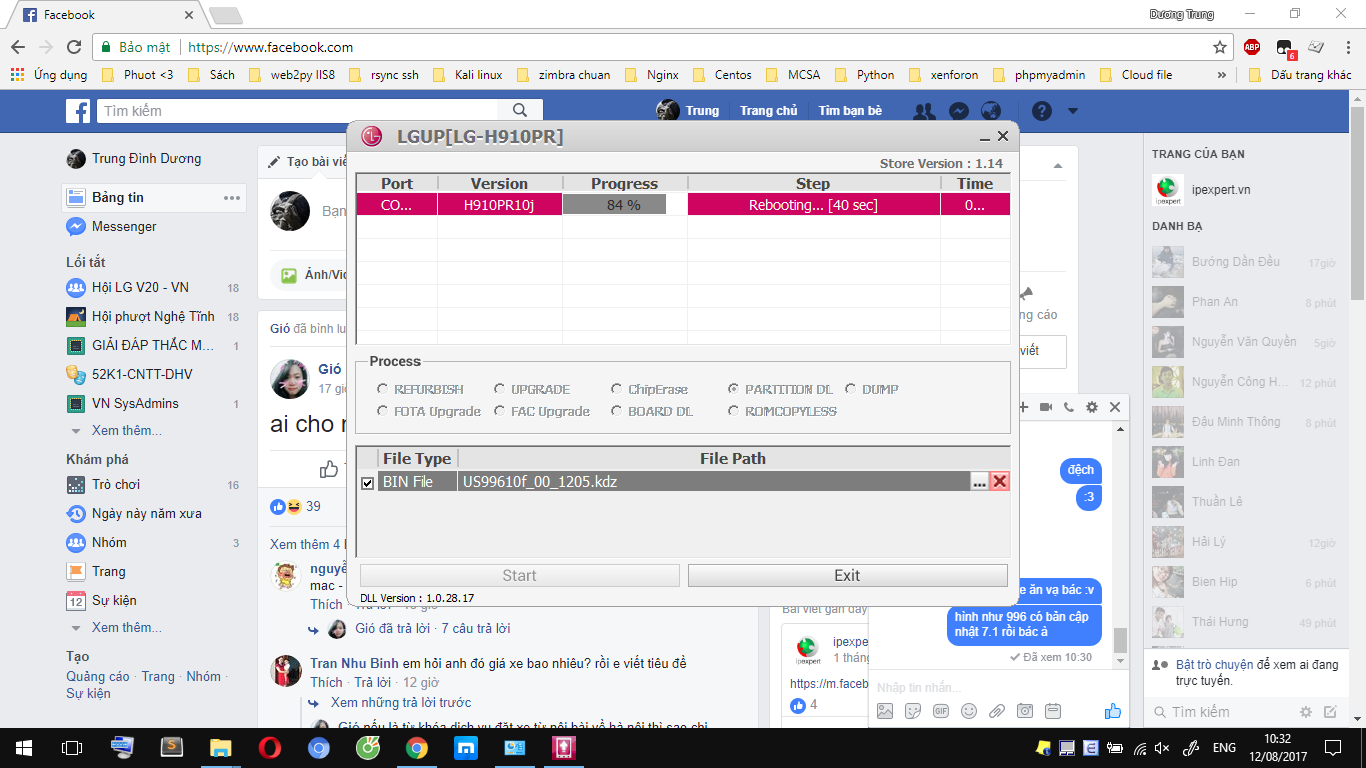

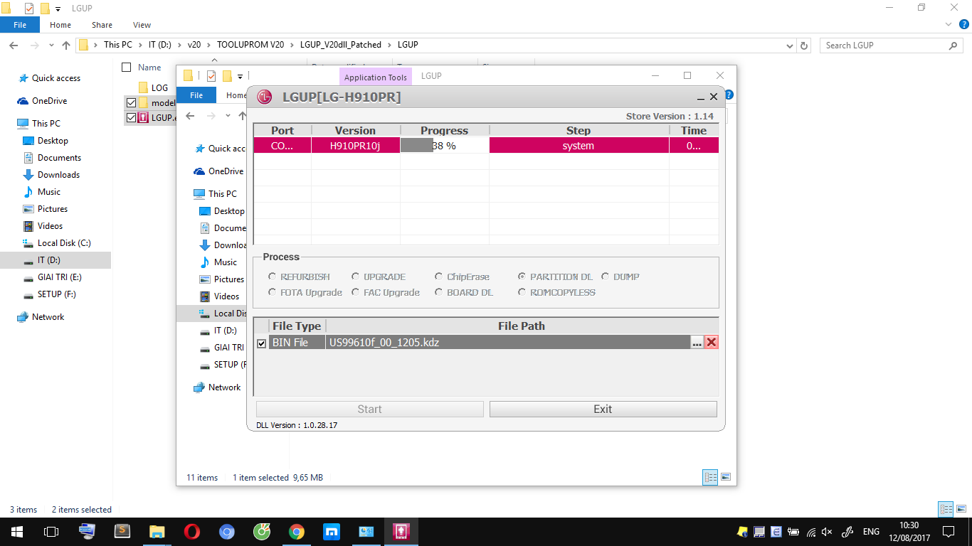

I have a h910 device and I have kdz to h910pr version. But I can not unlock device to root. And I used this way. It can kdz us996 files without problems

Yes. I used this method for my h910 device. My english is very bad sorry
