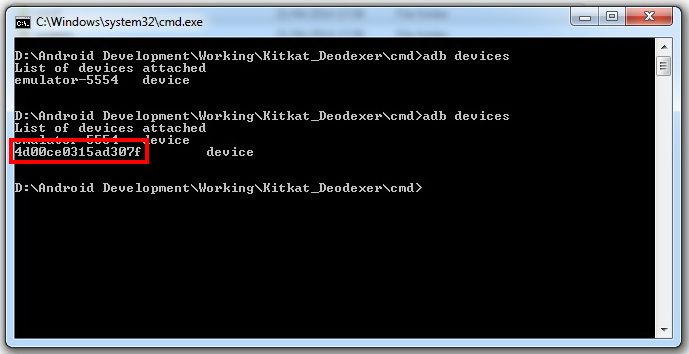

i always get a error message.. error : more than one device and emulator
AndikaTedja
Feb 24, 2013
162
205
83
Denpasar, Bali
Try this
Okay try this (Remember to turn on usb debugging)
1. hold shift button + right click on cmd folder(in Deodex_Kitkat folder) then click "open command window here"
2. Type adb devices (allow on your phone)
3. Remember your device number or whatever is that :p
4. Open main.bat with Notepad++ or Notepad
5. Sarch this line
cmd\adb pull /system/app system\app
cmd\adb pull /system/priv-app system\priv-app
cmd\adb pull /system/framework system\framework
6. Add
-s xxxxxxxxxxxxx
after cmd\adb line (for example mine is 4d00ce0315ad307f)
so it would like this
cmd\adb -s 4d00ce0315ad307f pull /system/app system\app
cmd\adb -s 4d00ce0315ad307f pull /system/priv-app system\priv-app
cmd\adb -s 4d00ce0315ad307f pull /system/framework system\framework
7. Save
8. Run main.bat
Let me know the result
