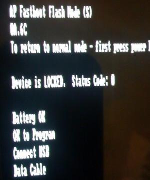

5) GO INTO FASTBOOT MODE
Shutdown your tab.
Press and keep "-" volume key => press Power key => release 2 keys => your tab will boot in fastboot mode.
Now open a command shell on the folder where you have extracted the 2 .zip before (just press Shift on your computer keyboard & right click with your mouse)
Please verify that the path written on the shell is the good path :
Write in it with your computer keyboard :
moto-fastboot flash motoboot motoboot.img
moto-fastboot flash devtree device_tree.bin
moto-fastboot flash boot boot.img
moto-fastboot flash system system.img
moto-fastboot flash logo.bin logo.bin
moto-fastboot flash cdrom cdrom
moto-fastboot flash preinstall preinstall.img
moto-fastboot flash recovery recovery.img
moto-fastboot -w
moto-fastboot reboot

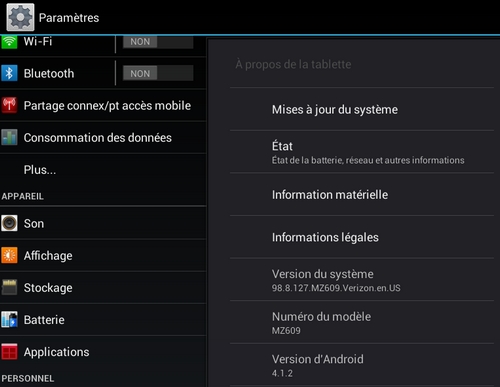

7) HOW TO DOWNLOAD 4.1.2 OTA
Configure your tablet like a new (Google account, localization, wifi...) until you can use it like before.
Go to Settings, About Tablet, System Update and... BING ! The OTA is here !
Download it, when it's 100% the tablet will reboot. Let it do the work, it takes several minutes : first you will think that the tab is stuck on the "CustomerID error, Contact Dealer..." but after 1 minute, the recovery will install the OTA file automatically.
After the update, the tablet will reboot. And voila, you are on Jelly Bean 4.1.2

I have the Xoom 2 mz607 and i followed the How-to,
but in the FastBoot, it says that my device is Unlocked
I follow every thing and my tablet boot on the Welcome screen without the message you had.
If i start the wizard, the tablet reboot again... and again...
What can I do ? I test everything...
Thanks for your help !
(I'm french sorry for my english level)
