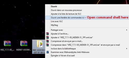

5) GO INTO FASTBOOT MODE
Shutdown your tab.
Press and keep "-" volume key => press Power key => release 2 keys => your tab will boot in fastboot mode.
Now open a command shell on the folder where you have extracted the 2 .zip before (just press Shift on your computer keyboard & right click with your mouse)
Please verify that the path written on the shell is the good path :
Write in it with your computer keyboard :
moto-fastboot flash motoboot motoboot.img
moto-fastboot flash devtree device_tree.bin
moto-fastboot flash boot boot.img
moto-fastboot flash system system.img
moto-fastboot flash logo.bin logo.bin
moto-fastboot flash cdrom cdrom
moto-fastboot flash preinstall preinstall.img
moto-fastboot flash recovery recovery.img
moto-fastboot -w
moto-fastboot reboot
