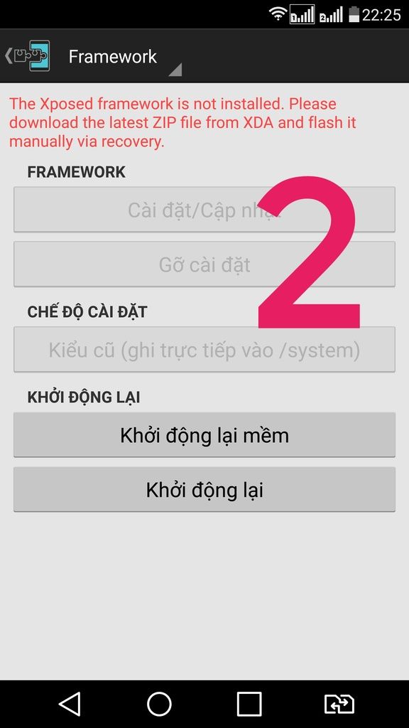

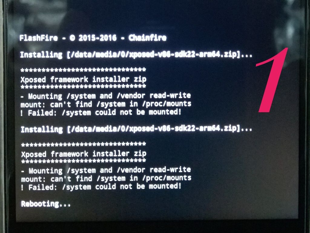

Hey man........ I just had a issue . FOR LG G4 H818P .
If someone have a error as Pic1 when flashing with Flashfire :
And Xposed will be error as pic2 :

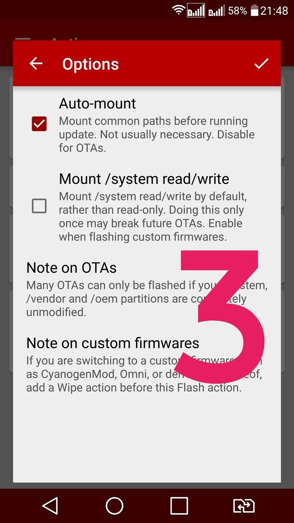

And now my issue is you need to check as pic3 when flash with Flashfire :
And it work well on my Lg G4 H818p , :)
