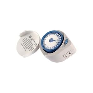

Say hello to the appliance timer (you can get them at the dollar store):
http://www.amazon.com/50460-24-hour-Multi-Event-Appliance-Timer/dp/B000G1MD80
100% Charge Procedure:
Set ON 2 hours before you normally wake up.
Set OFF sometime prior to when you go to sleep.
You get:
100% charge every morning
If you oversleep, worst case scenario you end up with 90%.
BUMP Charge Procedure:
Set ON 3-4 hours before you normally wake up.
Set OFF 2 hours after that.
Set ON immediately after OFF,
Set OFF .5 hours after,
etc... until you've bumped to your desired level.
From now on just plug your phone in when you go to bed, and wake up to a 10% fresher battery every morning!
If you normally deplete your battery to a point where it will not make it until 2 hours before you wake up, consider setting your first OFF to 30 mins after you normally go to sleep.
ENJOY. :D

Almost all timers you can set an on/off time for half-hour increments- the digital ones you can probably be more specific.
Mine I set off/on 3 times right before I wake up.

Most timers have "multiple events." You just set them using little plastic pins so it really doesn't cost them anything to give you a bunch of pins.
I personally leave my phone on, as it is my 2nd alarm clock. I have my inital off set to 2am (about 30 mins after my usual sleep time) to bring the battery up to the optimal 40% charge it should sit at. My on is set to 6am, 2 hours before i normally wake up. I do not bump, as i am not baller' $$$$$.
