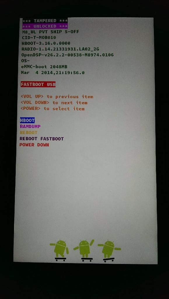

2)reset your "tampered flag"
enter the following:
adb devices
adb shell
su (if needed to get a # prompt)
echo -ne '\x00' | dd of=/dev/block/mmcblk0p6 bs=1 seek=5314564
(i would very strongly recomend you copy/paste this)
exit
(exit a second time if you need to to get back to a normal > prompt)
adb reboot bootloader
verify tamered is gone

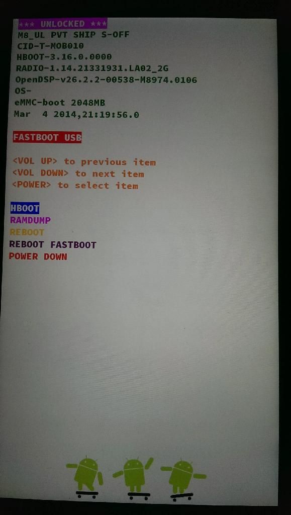

adb devices
adb shell
exit
your cmd window should look like this(red= my inputs,blue=additional comments):
c:\miniadb_m8>[COLOR="Red"]adb shell[/COLOR]
[email protected]_m8:/ $ su
su
[email protected]_m8:/ # [COLOR="red"]echo -ne '\x00' | dd of=/dev/block/mmcblk0p6 bs=1 seek=5314564[/COLOR]
ock/mmcblk0p6 bs=1 seek=5314564 <
1+0 records in [COLOR="Blue"][COLOR="red"]adb reboot bootloader[/COLOR]
c:\miniadb_m8>[COLOR="red"]fastboot reboot[/COLOR]
rebooting...
finished. total time: 0.022s
c:\miniadb_m8>
