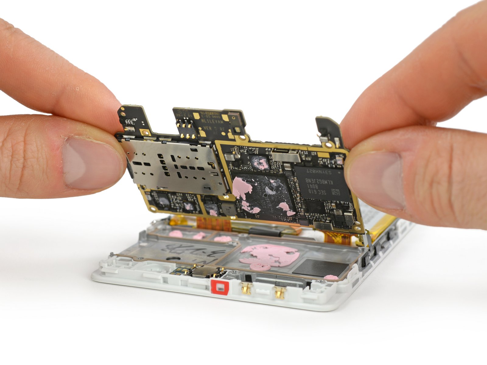

The parts
https://nl.ifixit.com/Teardown/Huawei+P9+Teardown/62348
The exact part
https://d3nevzfk7ii3be.cloudfront.net/igi/hPqtDsT1TBTEbROq.huge
As I see two full functional sim holders, the second is for sd too. This motherboard has nfc chip so I think this is an L09.
Yes that's a L09. But as I said it will be very difficult to do a dual sim on Eva L09. Now I'm gonna test the other paid program cause I already tested with dc. By the way cloning imei as I experienced before with mediate device won't work because only one imei can be registered on the line. If the imei matches with the other sim then most likely it's going to be disconnected from the operator in the best scenario with no signal for both sims .. . Or conflict with your other sim and ban imei. It is possible to generate another imei with some tools but at least in EU there is a law that forbids it and im a bit scared to try it. Now as far i know there is a range of banned imei from that generator. Anyway because of curiosity I'm gonna try the other tool and report back tomorrow
Reactions: kergekecske
