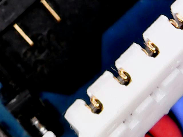

Trust me it looks fine but the trouble is from there, not just this tablet but others all have the same problem.
Look at the white female connector, it's also the source of problem if positive cables ( red ) and negative cables ( black ) don't make good contact
with six pins of black male connector. I see the trick of disconnect and reconnect battery cable many people do to fix intermittent power or battery quick
discharge, the problem is from loose female white battery connector.
You know how to solder so the fix is easy: put a little solder over red and black cables where they make contact with male connector.
You need a knife to cut these small plastic on the white female connector like this one:
This is an example of bad contact, the pin of male connector is between the opening of the tip of battery cable.
Look at two on the right side, two pins sit in the middle of the opening:
