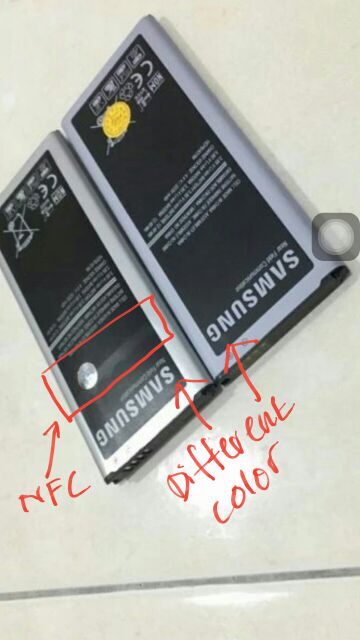

i'm lucky because i bought 2 times authentic. it's not difficult to know it's authentic or not. see included picture. fake battery mostly wont have nfc chip inside. battery with nfc have slightly protruding, fake is flat surface. u can feel with your finger. authentic have perfect font printing and easy to fit inside phone.
