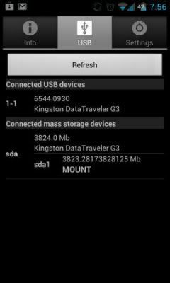

Build 5 released
ChangeLog
  • Added ability to turn charging on/off while the USB is connected
  • Added ability to change the Host mode driver. Currently three drivers are present: S3C High-speed (the default), S3C Low-speed/Full-speed (this disables USB 2 mode. Use this if you want to have USB 1 compatibility), and DWC (a separate driver for the same OTG specification, that will probably get into upstream)
  • Fixed some small issues regarding cleanup after cable is disconnected
The DWC driver does NOT yet work, it will probably crash your phone if you try to use it. I however hope that I will be able to fix it. The other two drivers work well of course. Note that you have to turn off host mode if you want to change the driver (then turn it back on).
Also note that to change the charging mode you have to unplug every cable from the phone before changing the charging mode. In ICS it seems that the small battery icon on the top and the lock screen will still say the phone is charging, but the battery menu in the settings will properly tell you they are mistaken and the battery does not charge indeed.
Usb Host Controller has also changed to version 0.2.
I made a separate thread for it: http://forum.xda-developers.com/showthread.php?t=1468531
Changes include stability fixes, a new icon, support for the new features mentioned above (changing drivers, disabling charger, etc.) and two nice commands:
  • Reset USB device
  • Re-read partition table
The latter command should probably solve a few issues where the flash drive was recognized, but there were no partitions to mount. It also solves the issues of connecting other Android devices. (Simply re-read the partition table after you have enabled usb mass storage mode on the other android, and you will be able to get files from the other phone too)

Got a cheap OTG cable off of eBay and spliced in the power wires from an other USB cable. Was able to see and copy from the thumb drive and also was able to watch a movie directly from the drive. Was able to charge the phone during the same time.
Next up is to see if an Ant+ receiver will work.
