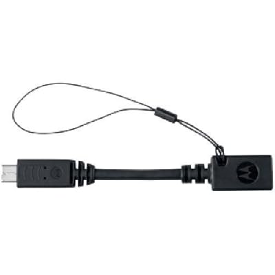

I just made a Factory Cable, just-in-case. Figured it would be a lot easier if I wasn't under the stress of a bricked Xoom.

Oops, you're right! The breakout board needs to be at the micro-B end, not the USB-A end.
Redo. Get these two:
http://www.sparkfun.com/products/10031 (USB Micro-B Plug Breakout Board) USD$4
http://www.sparkfun.com/products/9966 (USB Mini-B Plug Breakout Board) USD$2
Have along a regular USB-A male to mini-B male cable, some jumper wire, and a soldering iron (sorry! but it's really easy!). You know the deal, pin 1 (mini) to 1 & 4 (micro), 2/3/5 are straight-through.
Final cost: still $6! (plus shipping)

Make a Motorola factory cable for Xoom w/ no soldering
@Kippui
The breakout method is versatile in that it can be reconfigured for any pinout, and thus can be (re)used for any custom USB connection. You can also use it as a USB analyzer. But for a specific connection, eg this "factory" cable, try the no-solder method below:
http://talk.maemo.org/showthread.php?t=14092
The how-to is for an OTG cable, but as TX2000 said, it's basically same as the Moto factory cable. The hard part is to find a cable that has all 5 wires connected and correctly color-coded, which is in the how-to,
http://www.amazon.com/gp/product/B000Y032X8 (mini-B female to micro-B male adapter) USD$3
Ignore the instructions in the how-to, as we only need the link to the cable. Use a utility knife and remove a 1" section of the cable sheath to expose the 5 wires. Per the article, they should be correctly color-coded. Use a tap splice connector (probably 22-26 AWG, available in any hardware store or online) to connect the red (#1, or VCC) wire and brown (#4, or ID) wire together. Electrical tape the exposed section. No soldering.
Note that if the cable doesn't have the correct color code (red/green/white/brown/black), you'd have to cut the connector to trace each wire to the pin, which is a PITA, but still doable. Hence I'm linking to this article, which is linked to a specific part with (hopefully) correct color codes.
