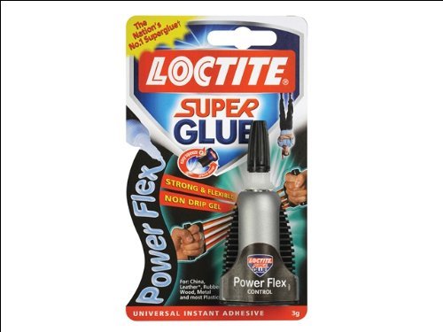

seems to tick a lot of boxes, although one or two others had temperature ranges included as part of the sales pitch - I've used that stuff before for general purposes to be honest, and it's quite fluid - when the connector falls out is there any indication as to how the original glue was applied by sony, and is there much risk of the replacement glue seeping into the rest of the phone?

I'm not sure if it would but if it's liquid then it might be hard to cover all holes for water entry. I used a clay adhesive and though it was hard to apply because the area is small, it did a great job of sealing my magnetic port so that I can still have water proof on the device and the port is very strong now.

Water proof Gorilla Epoxy works wonders, used it to fix the LCD to my LG G2 after a screen replacement, it has a 3200 psi rating.

You have to mix the epoxy and apply, it's a bit thick and gooey but you can still easily get the required amount. I used a small metal tab to get my G2s LCD fixed in place, as you know the G2 has a tiny bezel, if I used too much it would have gone into the LCD layers, but I avoided that.

    I used an epoxy from Loctite. I tried to find the exctualy one that I used here in Brazil at USA site but didn't find. But my concerns were: 10 minutes to work, so the glue should set after 10 minutes and it must glue metal.
    http://m.loctiteproducts.com/browse_products.pl/13
    I attached an image showing the results. If you take a closer look, you can see the glue and it may look a little bit ugly. But if you don't give a close look, you can't even see the work I did.
    But I'm very happy. The port is very strong now.
    Edit:
    Just to add more info, I used a very small needle to feel the gaps. You have time to clean if you do a little mess.
