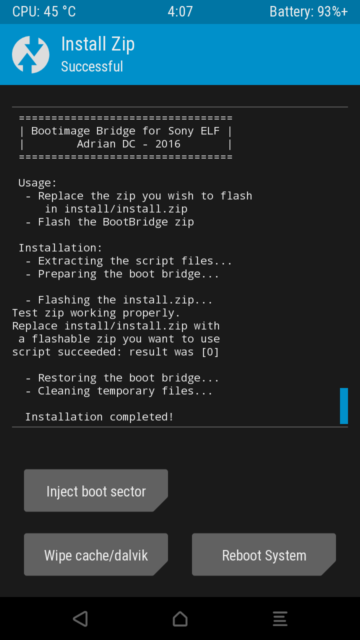

I invite you to have your ROM's boot.img flashed into boot directly,
then flash my Boot Bridge as it is, even without a rooting zip, like in my screenshot,
and let it run to see the bridge creation then restore perform.
If anything goes wrong and the bootimage is not readable,
the process will stop and nothing will be done.
In the very worst case, the rebuilt boot image doesn't start
and you simply fastboot the image you came from.
