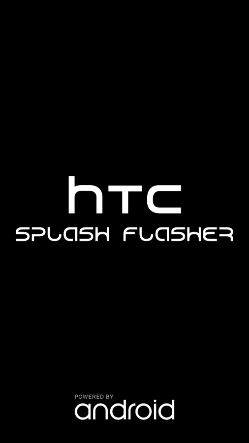

HTC Splash Flasher
Eliminates having to include the android-info.txt file from firmware package.
Therefor it is model and carrier independent.
(can be flashed on any HTC 10)
Want to change your Splash Screen on the fly?
Tired of having to use ADB/fastboot when you want to make such a simple change?
Then this may be for you.
This enables you to easily swap between 3 included Splash Screens.
!!!! YOU MUST BE "S-OFF/Bootloader LOCKED" TO USE THIS UTILITY !!!!
Provided options are:
HTC 10 Dev Edition - Dark HTC Splash
HTC 10 Verizon Edition - White HTC Splash
Custom - Included one in the package, which you can keep or replace with one of your choosing at any time.

selected htc dark splash screen did installation and its on please wait screen for almost 2 minute or more....
going to do a force reboot and will report back...
edit:- did a force reboot and tried flashing this time with verizon splash screen flashed fine and reboot but don't see a change....
edit2:- flashed successfully htc dark splash screen but again no change in splash screen....

Unfortunately it does not work here. The script says "Succsess" but nothing is changed. What's wrong?
I'm out of town, on a job right now, so I can't help you much.
Plus, that's his tool, best to ask him in that thread mate.
Sorry about that.
Sent from my HTC6545LVW using Tapatalk

Sorry, you missunderstood. The compiling the slpash1.nb0 works fine.
The Aroma flasher does not work. Tried all three variants - nothing changed.
Maybe your rom doesn't have busybox.
Not sure, worked fine in testing.
Can't do anything with it at the moment.
does have busybox support... currently tried on Lee's with similar result to above...
no worries will wait for you to check on it whenever you have time :)
thanks :good:
