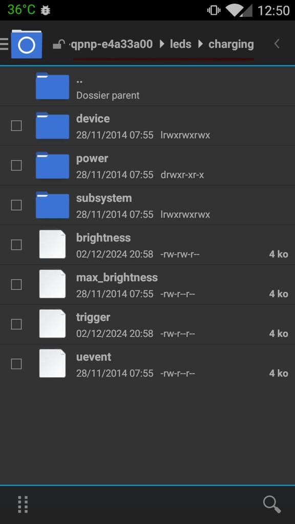

in /sys/class/leds/charging/trigger we have these triggers available :
[none] bkl-trigger usb-online flash0_trigger torch_trigger mmc0 battery-charging-or-full battery-charging battery-full battery-charging-blink-full-solid bms-online
easy to change them using :
echo battery-charging >/sys/class/leds/charging/trigger

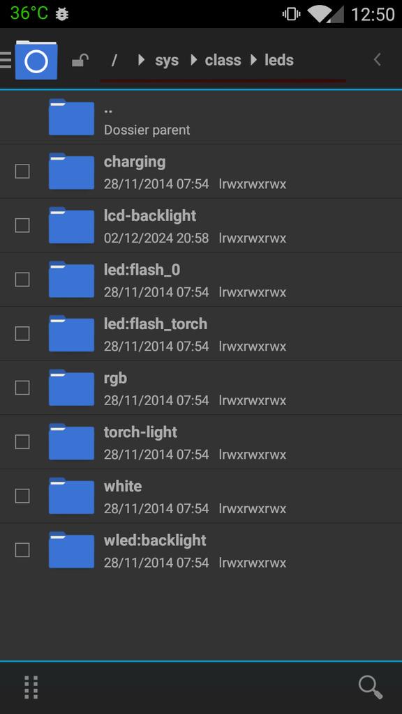

The same is available in /sys/class/leds/white/trigger, and /sys/class/leds/white/brightness allows to dim the LED, though :
  • During test i was able to show that using /sys/class/leds/charging/trigger overrides any other trigger (if a notification comes, then it won't change the pattern) After extended test, it turned out that MotoG also have two LEDs
    [*]Though using /sys/class/leds/white/brightness allows to use 0~255 values to dimm the LED, and /sys/class/leds/white/trigger works; it is overridden by any incoming notification that set brightness back to 0.
edit : Current knowledg is :
  • /sys/class/leds/charging/trigger → first LED, can be set to on/blinking while charging, although at full brightness.
  • /sys/class/leds/white/trigger → second LED, can be dimmed, but the LED turns back off when a notification comes in.
For now, the best way is to set "first" LED (/sys/class/leds/charging/) for charging using dedicated trigger and keeping the "second" one to none and get both working together this way.
What we need is to find a way to dim the "first" LED
