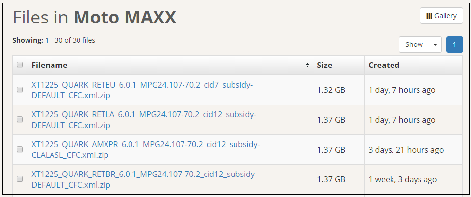

Guys, is it normal that I'm still waiting OTA for Mexican 5.0.2 (22.34.13 retla)? My bootloader is unlocked and phone originally had puertorican firmware because was bought in PR. System updates keep telling me that they were up to date. Maybe it's because I'm in Europe now?:confused:
ChazzMatt
Nov 30, 2010
18,326
14,179
253
Atlanta, Georgia
Still waiting for 5.0.2 when Marshmallow is out for the Mexico phone? 5.0.2 was released over a year ago for the XT1225.
It's entirely possible you are not getting the OTA because something in your phone is still saying "PR".
Back last year I flashed my Puerto Rico XT1225 and Mexico XT1225 to India Moto Turbo XT1225 as it got Lollipop 5.0.2. first. So, all the XT1225 are totally compatible with each other. BUT you should not flash an OTA from another region over your phone. You should flash the complete image, via ADB like found here in this thread or the link I show below (IF you have an XT1225):
I have various 5.02. images in this thread.
If you specifically want Mexico Lollipop or Marshmallow, go to this link below... ALLthe images are here in this link, even 5.0.2 (but downloads are slow). This is a screenshot of the Marshmallow images, but Lollipop is there also.
FILE FACTORY - QUARK IMAGES
http://www.filefactory.com/folder/f9d1880e6c5b4800/?sort=created&order=DESC&show=50
@iiWoodstocK has a TWRP-flashable version of the Brazil Marshmallow image over in the Droid Turbo forum. It uses whatever radio you already have installed. It even works on Droid Turbo (just no VoLTE) as well as all the other Quarks:
[ROM][6.0.1][Stock][Odexed]MPG24.107-70.2 Brazilian 6.0.1 for XT1254[TWRP Flashable]
http://forum.xda-developers.com/droid-turbo/development/rom-mpg24-107-70-2-brazilian-6-0-1-t3426234
this ROM is just factory Marshmallow with a modded build.prop. I didn't include any radio in the .zip, so it uses whatever is currently on the device. Aside from my build.prop tweaks, this ROM is even usable for Brazilian XT1225 users, but the device will say it's a Droid Turbo and contain useless CDMA build.prop lines.

No, I have 5.0.2 which doesn't update to Marshmallow. Bootloader was unlocked so I flashed Mexican 5.0.2 year ago not to wait puertorican OTA for 4.4.4. Since then I haven't received any updates. And now it seems all regions finally received Marshmallow but OTA for me is still out there.
Then you are waiting for the 6.0.1 OTA. ;)
clusten
Dec 5, 2012
31
9
You need to go back to your region S.O.
If your phone was puertorrican Maxx, then you need to flash the puertorrican Lollipop.
Motorola doesnt send the OTA if you change the firmware region.

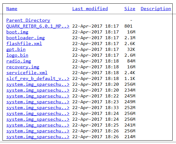

Sanju_sandy
Jul 9, 2017
7
Stock recovery needed urgent [Reply appreciated]
short story::
can anyone please upload stock recovery.img and stock boot.img of Moto XT1225 Indian firmware after december OTA update
long story::
my device is currently in dead state
only able to boot into download mode /no recovery/not able to boot into OS
and bootloader locked state
as im currently in oem locked state im unable to flash custom recoveries and old stock recoveries so i would like to get latest stock recovery of the Indian firmware i.e after december update
basically i need recovery.img and boot.img file from this firmware file
XT1225_QUARK_RETEU_6.0.1_MPGS24.107-70.2-7_cid12_subsidy-DEFAULT_CFC.xml
as this firmware is not available to download anywhere in internet

short story::
long story::
and bootloader locked state [/B]
Looking for the same from long ago :confused:
@sourav92, is your bootloader locked also? With bootloader lock, it's hard to help.
With unlocked bootloader, we could tell you exactly how to recover the phone.
  • You could flash the exact same version of XT1225 firmware you need, but just for another region (Brazil) and it would work PERFECTLY. Has the December update and everything.
    XT1225_QUARK_RETBR_6.0.1_MPGS24.107-70.2-7_cid12_subsidy-DEFAULT_CFC.xml -- but it's for Brazil.
    With an unlocked bootloader, that would not matter. In the past, I have flashed India Turbo XT1225 firmware over two of my three XT1225 (both bootloader unlocked) -- one of them from Mexico and one from Puerto Rico. The XT1225 are all the same device, same FCC ID, just different model names for different regions. But with locked bootloader, you can't do that.
  • Or with unlocked bootloader, you could even downgrade to slightly lower version of India firmware -- but just omit GPT.bin file when flashing in ADB. You could even downgrade all the way to Lollipop, and I know one person who flashed Kitkat 4.4.4 on his Moto Turbo XT1225. Kitkat never came with Moto Turbo XT1225 (it launched with Lollipop 5.02, several months after Latin America XT1225 launched with Kitkat 4.4.4.) So, they used a Latin American XT1225 KitKat image to flash over their India Moto Turbo XT1225 (which had unlocked bootloader, of course).
But with locked bootloader, you have no choices like that. Bootloader unlock for the XT1225 is free from Motorola with code given on request. This can't help you but may help someone else:
UPDATED GUIDE: How to unlock your MOTO MAXX/MOTO TURBO bootloader/install TWRP/root
I hope both of you find the the firmware you need. But as these Quark phones get older, people are not uploading firmware like they used to (even on File Factory) because there's not as much demand, I guess. So, you have to TAKE CONTROL of your device, OWN your device -- unlock the bootloader and you have many, many more options.
