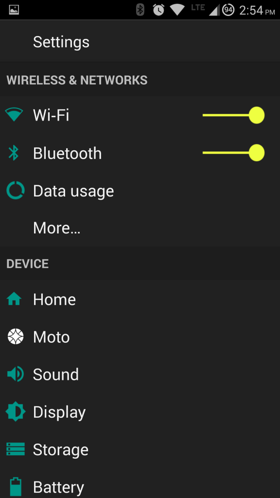

(On my daily phone, I'm running 4.4.4 from factory, but rooted and I have Gravity Box with lots of custom ROM features and I'm even running a Lollipop theme using Xthemes, which is an Xposed app. Can't do that without root.)

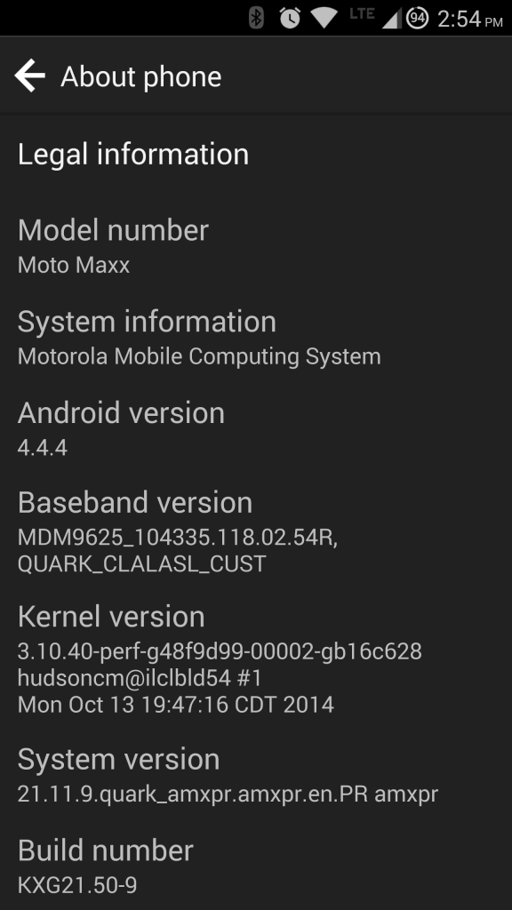

MOTO MAXX IMAGES (XT1225) - PUERTO RICO
SYSTEM VERSION: 21.11.9.quark_amxpr.amxpr.en.PR amxpr
BASEBAND VERSION: MDM9625_104335.118.0254R, QUARK_CLALASL_CUST
My first Moto Maxx is from Puerto Rico. Although sold by Claro, this image is unlocked and has ONLY Motorola software just like the Mexican Moto Maxx. So, there's nothing "retail" about it, it's factory. (The Moto Maxx sold by Claro has no bloatware). I posted these images before, nothing different, just putting them all in one post so they are easier to find.

"Android version", "Kernel version", "Build number" are identical on both Mexico and Puerto Rico models. Only the "System Version" and "Baseband Version" info differs. However, I cannot tell any difference between the two. Same apps out of the box, same behavior, same GSM/HSPA/LTE bands enabled.

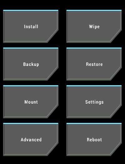

6) Follow instructions from the op post to use command window (via ADB) to boot phone to the bootloader, and then use the command window (via ADB) to flash the "one time" TWRP recovery boot file.
This will not install TWRP recovery permanently. (You can do that later if you wish.) But you need to at least boot into "temporary" TWRP recovery to install any of the images.
7) In TWRP, then choose "restore" and browse to the TWRP recovery image you put on the phone from step #2. Choose that, and restore.
8) Reboot phone.

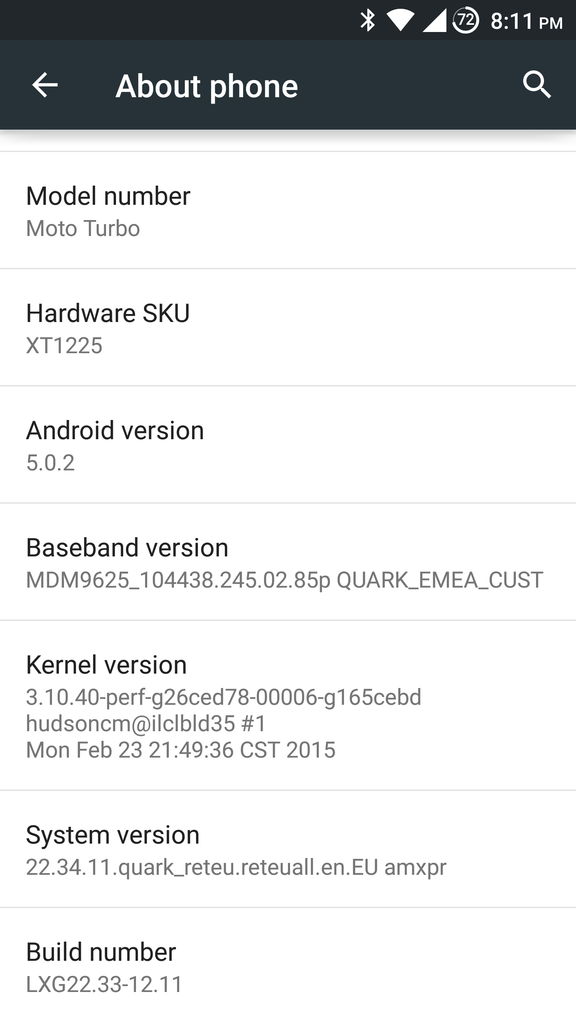

MOTO TURBO IMAGE (XT1225) - INDIA
QUARK_RETEU_INDIA_5.0.2_LXG22.33-12.11_cid7_subsidy-DEFAULT_CFC.xml.zip
This is the stock Lollipop 5.0.2 image that was released with the Moto Turbo XT1225, which is the same Quark device as the Moto Maxx XT1225. Just re-named for another market...
This is the firmware PUBLICLY released by Motorola on the Moto Turbo phones, bought by customers. It is NOT the subject of any confidential non-disclosure agreement. It is NOT any kind of soak test, beta test, whatever. It is FINAL factory software, shipped with the Moto Turbo XT1225.
This is my Moto Maxx XT1225 converted to India Moto Turbo XT1225 , flashing this image.
The advantage is Motorola lists all the current specs, including enabled bands for the Moto Turbo XT1225. Although the Moto Maxx XT1225 has the exact same bands (LTE and HSPA), on the Latin American Moto Maxx websites, Motorola does not admit all those bands are enabled, even though they are (like AT&T LTE band 5 and T-mobile HSPA band 4). By flashing the Moto Turbo Lollipop image, you can prove to other people you do indeed have all those bands, because it's on the Motorola Moto Turbo specs page. ;)
http://www.motorola.in/consumers/mobile-phones-in/Moto-Turbo/moto-turbo-in.html#moto-turbo-specs

If you are flashing an image for another country (example: Puerto Rico KitKat 4.4.4 to Brazil or India Lollipop 5.0.2) and you do not unlock the bootloader, if something goes wrong you HAVE to wait until that 5.0.2 image is released for your phone and flash that instead. Whenever that is.
When I flashed my Mexico KitKat 4.4.4 to India Lollipop 5.02, I messed up first time and didn't flash the entire image. But it was OK, because my bootloader was unlocked. ;)

I don't get it. I put the zip in the phone storage. When I go to restore on twrp nothing appears. If I go to install its right there.... So should I restore or instalaste in order to flash one of those twrp backups?

You have to extract the files from the zipped folder, and move those to your TWRP recovery folder. The folder is zipped just to make sure you have all the files together when downloading them. You don't flash it (like an installation file), you have to use an extracted, unzipped version of the files to restore through TWRP.

I extracted them in the computer and passed them to the twrp folder and still nothing appears....
---------- Post added at 09:49 AM ---------- Previous post was at 09:27 AM ----------
I'm starting to hate this phone. I'll never get rid of KitKat.

You can use ADB to flash the factory image, instead of using TWRP.
You probably can't use TRWP to upgrade from 4.4.4 to 5.0.2. But afterwards, you can possibly use TRWP to switch from one Lollipop to another. My guess, as I did not use TWRP to upgrade. I flashed both my Mexico Moto Maxx and Puerto Rico Moto Maxx from 4.4.4 to India 5.0.2. In the next few days will try out Brazil 5.0.2 and/or CM 12.1.

Yes, I have Puerto Rico 4.4.4 and I was trying to restore Mexico 5.0.2 rooted with twrp.
