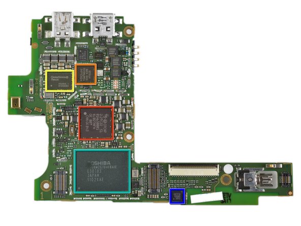

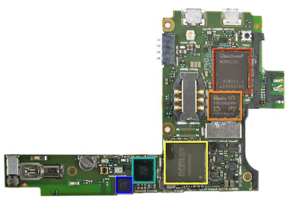

i guess that is the "Yellowed" one ?!
do someone know if it will be good also for WIFI not working at all ?
Congrats on doing what the other guy didn't know how to do, that pic from the site you got it from is easily accessible.
You are close with your guess. Right manufacturer, wrong chip. Check Step 10 from the site you got that pic from and you'll see the actual Qualcomm modem chip.
The wifi chip you are asking about is also identified in Step 10 from that site as a Broadcom BCM4329 802.11n Wi-Fi, Bluetooth 2.1, and FM Tuner
thanks for the corrections,
the picture of the PCB was the wrong side of the PCB.
this is the right side, and the RED chip is thw Qualcomm one, and the green one is of the WIFI.
