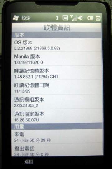

here's a peek at the existing spec of WM6.5 I had (most of the HD2's here are in Chinese)

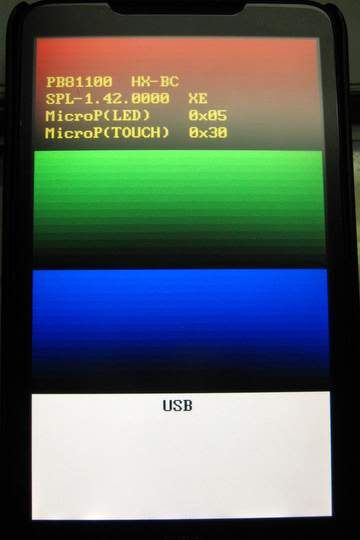

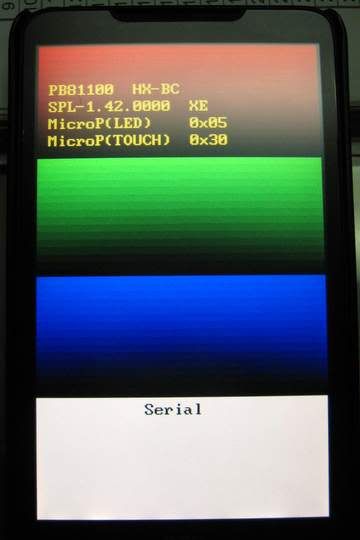

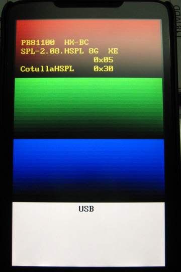

1. So first thing we need to do is to get into HD2's "bootloader mode" or the "Tri-color" screen.
- turn off your HD2 [I assume you got ALL you files/ Data on Backup already]
- hold the volume down button
- while holding the VOL. down then Press the POWER button
this is what you will see, notice the SPL version & the word "Serial" at the bottom. We need to change the SPL-1.42.0000 to SPL-2.08.HSPL
while in this mode, plug in your HD2 to the PC, noticed that the "Serial" has changed to USB.

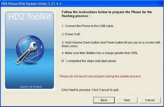

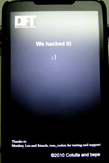

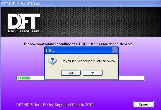

run HD2 NAND Toolkit & hit Install HSPL 1
a screen will pop-up & noticed the SPL's needed before rooting/ flashing can be done, press Next
select 2.08.HSPL
there you go, your phone now is in SPL-2.08.HSPL
Now go back to the bootloader mode as in 1. & noticed that the SPL-2.08.HSPL is already there & is in USB, unless you've unplug it.

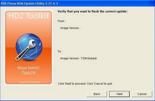

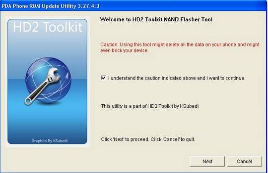

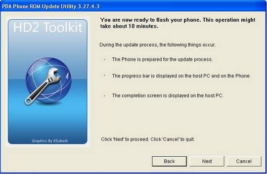

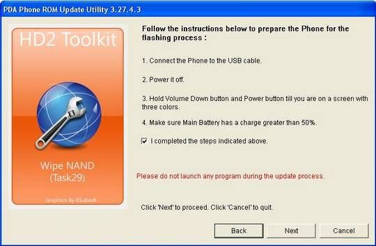

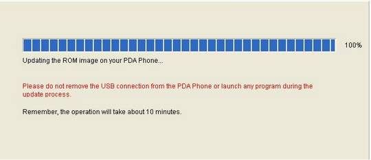

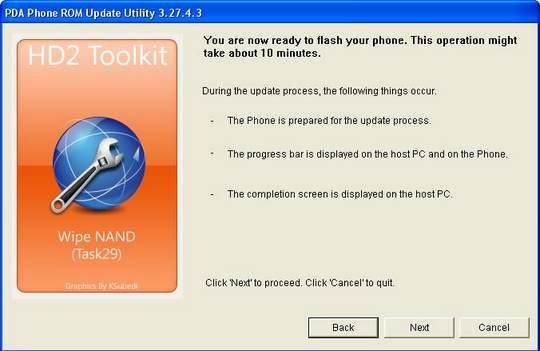

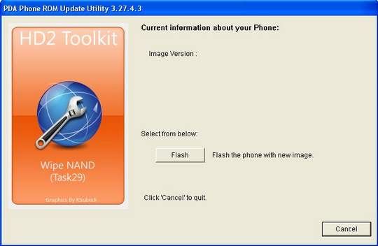

2. run HD2 NAND Toolkit & hit Wipe(Task29) 2

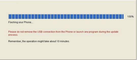

when a series of screen pops up just tick the Boxes & press next & flash :p

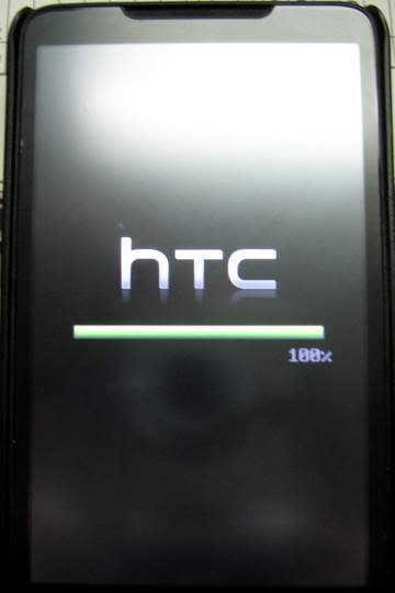

this is what you will see while flashing
& this is what it will be after Task29 - an empty shell :p

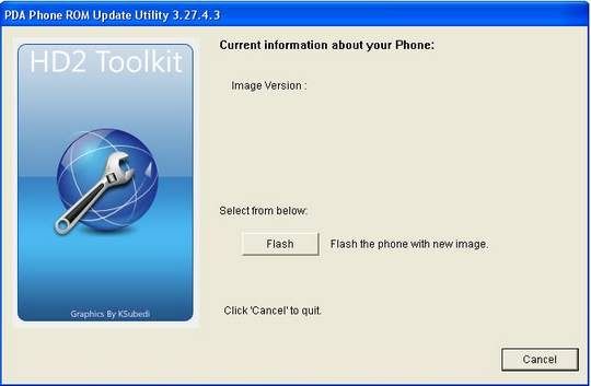

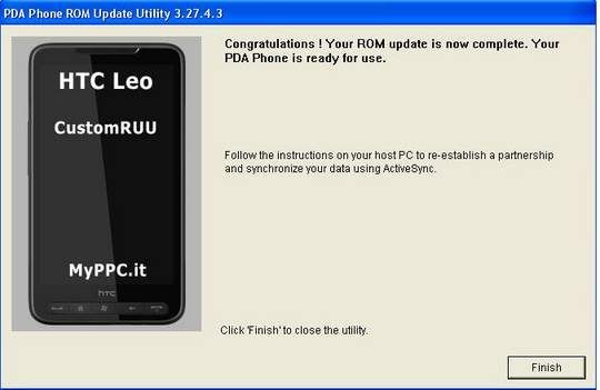

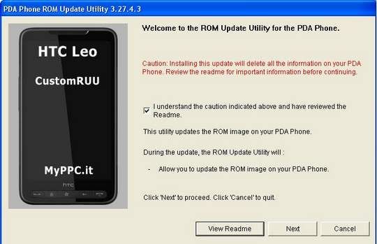

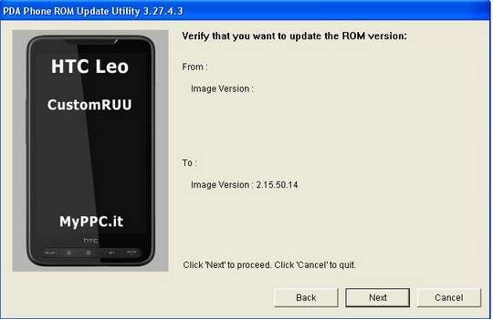

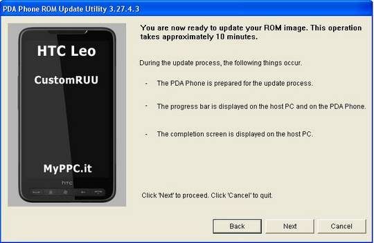

3. Now we need to flash the Radio 2.15.50.14 (you downloaded it right?) TMOUS users read Warnings >>> http://forum.xda-developers.com/showthread.php?t=669733

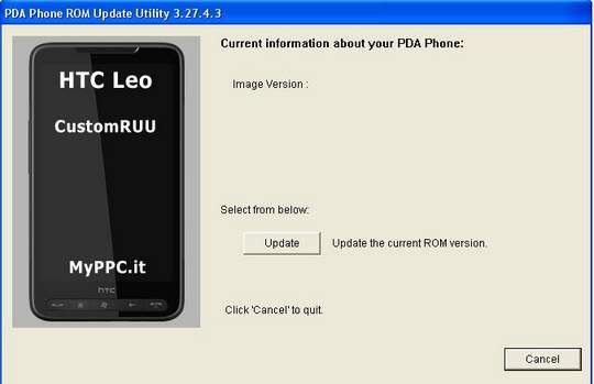

open the Folder [HD2_Leo_Radio_2_15_50_14] where the Radio is & run CustomRUU
when a series of screen pops up just tick the Boxes & press next & update :p
check out the Radio Version

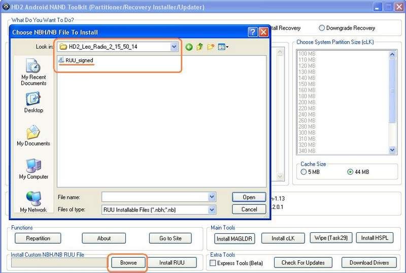

Alternatively you can flash Radio via HD2 NAND Toolkit
open Toolkit & select browse & point to the location of your Radio
just follow the next steps. Be Careful when flashing RADIO as it can Brick Your Phone

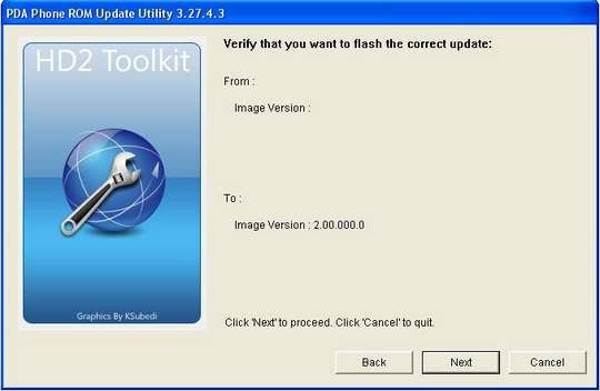

Now we are ready to flash magldr - a versatile bootloader for our HD2's
4. run HD2 NAND Toolkit & hit Install MAGLDR 4

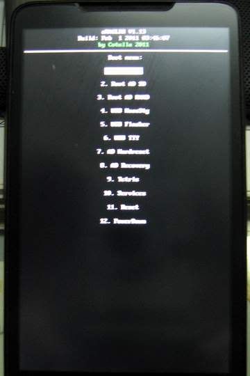

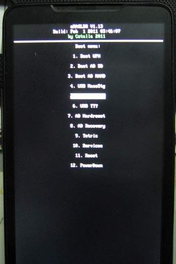

when the phone starts it will show you the magldr bootloader

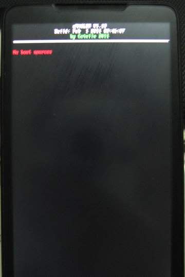

Now going down to #8 AD recovery (vol. button up/down) we see that CWM is still not there.
No Boot Sources

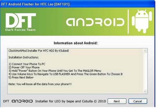

5. Now "I" repartition my HD2 which also places CWM into the HD2

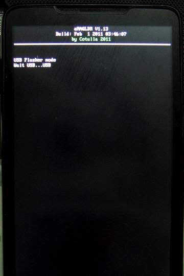

put the HD2 in USB Flasher mode via magldr #5
now in USB Flasher mode

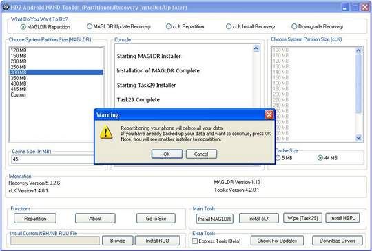

ticking Magldr Repartition 5 I choose 300mb 45mb cache & click repartition
a warning message will pop-up, press OK
a series of pop-up screen will appear just press next & finish
showing you the instructions w/c we just did
Booting the phone again & going into magldr & Choosing #8 AD Recovery we see CWM, the phone now is ready for either WP7 or Android.

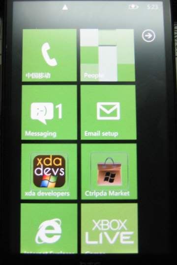

In this Phone I will flash WP7, I choose Pdaimatejam Rom Wp7.5 Tango **This will erase CWM **

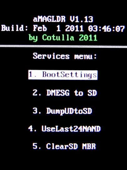

- in magldr choose #10 Services

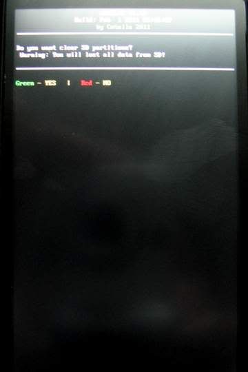

- choose Clear SD MBR press the green key(call key) to confirm
- choose uselast24Nand press the green key(call key) to confirm

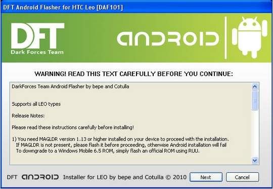

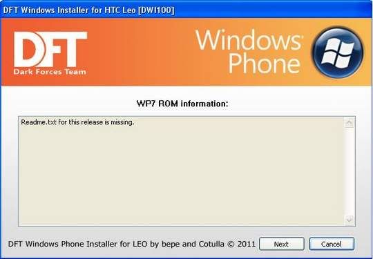

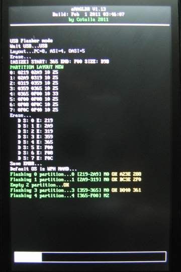

Put in USB Flasher mode option #5 in magldr

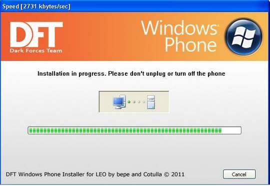

I then ran the DWI file of Pdaimatejam Rom Wp7.5 Tango
here is what you can see while flashing is going on

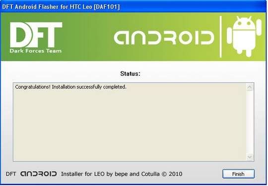

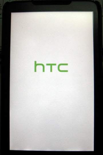

& there you have it

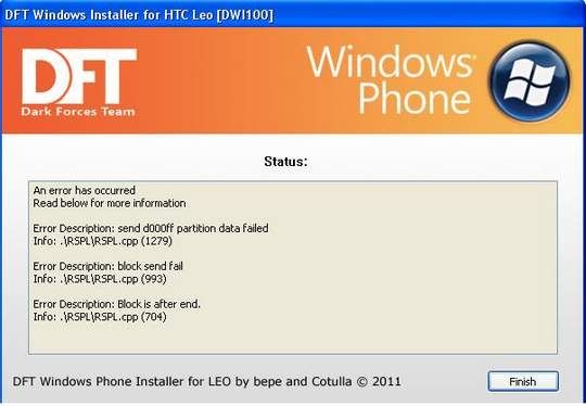

common errors that occur when there are problems with the SD card/ partition or forgetting to uselast24nand & clear SD MBR.

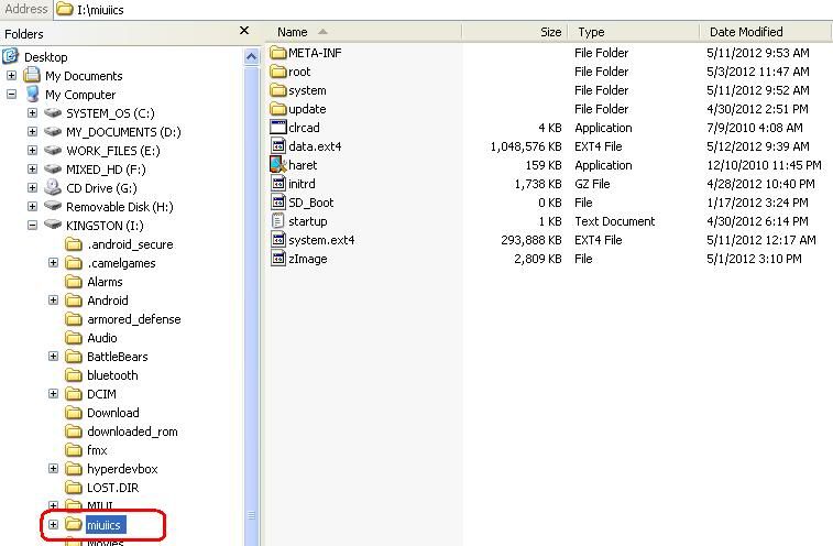

- after downloading the SD ROM (i choose MIUI SD for this) unzip the file on your PC then copy the whole Folder to the Root of your SD card.
my folder name is MIUIICS remember your folder name

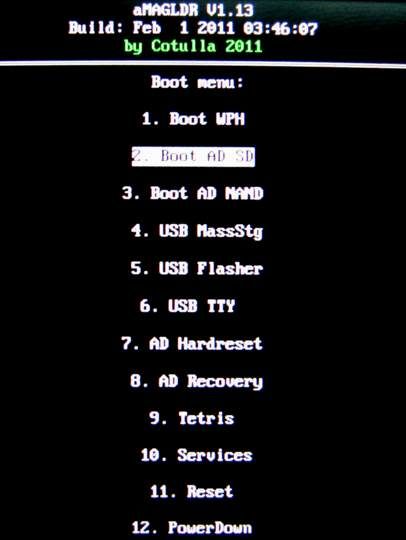

- Turn OFF you phone & take out the SD Card that is used by WP7 & insert the SD Card from which you copied the SD ROM Android.

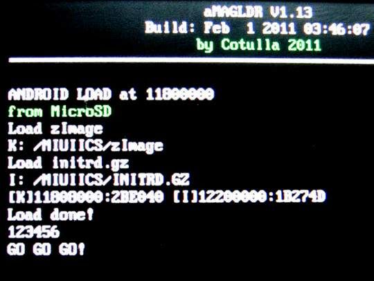

- Press the Power button & don't let go untill it boots into MAGLDR & then scroll down to #10 Service via the up/down Vol. Key

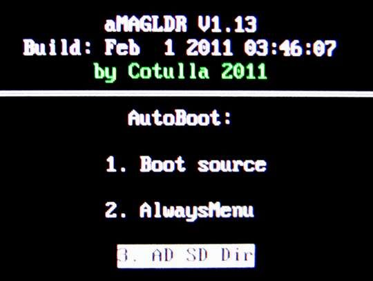

- Press the CALL button to get into the SERVICE MENU then select #1 BootSetting

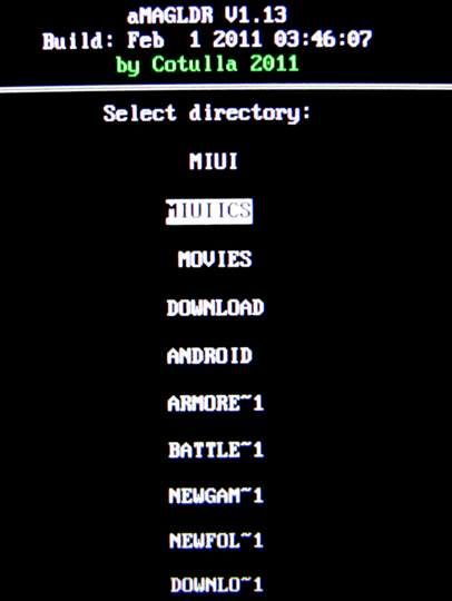

- Press the CALL button to get into the AutoBoot Menu then scroll down to #3 AD SD Dir
- Press the CALL button to Select Directory then scroll to find your directory & then Press the CALL Button again where the Folder of the Android SD Rom is located.
- which will bring you back to the Boot Menu, scroll down to #2 Boot AD SD then press CALL button
- then you will see the ROM booting

Why is it missing the line "CotullaHSPL" and touchscreen code 0x30/0x50.:what:

here is a video of my problem.
Edit: after do a task29 my phone still in the problem and not show the empty shell whith the HTC logo on screen.
http://www.youtube.com/watch?v=UAQnWUBrz80
Other symtoms.
- When i plug my phone via usb to the computer its turn on automatically and tuck on bootloader.
- If the phone are power on i cant turn off... not if i press the power bottom, so if i want to turn off the phone i need to take off the battery.
Some how your bootloader has become corupted, you should go to this thread and start trying each of the ROMs listed there. Do not try 2.01 as it has a non TMOUS compatible radio and WILL brick your device if you flash it to it. I recommend that you start at 2.02 and work your way down the list. When and if you find a ROM that will flash I suggest that you try flashing the 2.07 or the 2.09 ROM, if that is not the first ROM you got to flash. After you have flashed one of those ROMs you should be able to flash the 3.14.1 ROM and that will have you good to go again.
