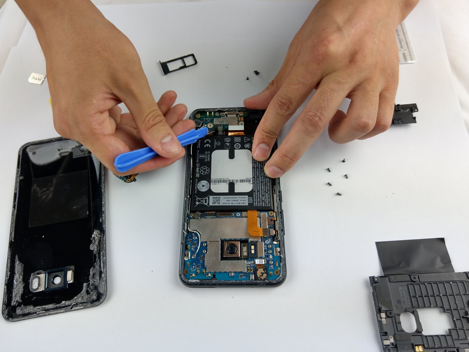

Yesterday the same happend to me.
I had the feeling that the battery connector wasn't properly connected/disconnected, so I searched for a picture to see if by pushing on the back of my device i could reconnect the battery connector (see this pic and this pic). Luckily this worked for me so now i can backup my data and exchange it (also luckily, im still within the voluntary 14 day returning period of my provider).
Hope this helps someone else too. :)
