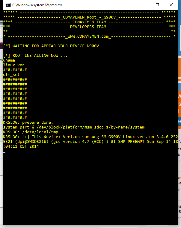

I'm having the same issue as Aireos. Did you get it working yet? I'm either at "ROOT INSTALLING NOW.." or it makes it a little further to "KRSLOG: [+] This device: Verizon samsung SM-G900V Linux version 3.4.0-252...." and it hangs there.. I'm not sure how long I should wait. When you say few minutes, do you mean 10+ minutes? Maybe it's because I am using Windows 10 64 bit? I guess I will try another computer.

Hey, I actually came on here to edit my post, but I see you already responded. I was able to get root. Just attempted to run "ROOT_G900V_5.0.bat" a few more times on my windows 10 computer..it eventually worked. I have version OK3 by the way.
I'm not sure which samsung drivers I have...Whichever ones windows 10 installed when I first plugged my phone in..if it even installed samsung drivers lol...
Thank's a lot. I almost thought there was no hope for the s5 since I accidentally accepted the OTA update.
Edit: for anyone wondering..when the ROOT_G900V_5.0.bat finally worked, it didn't take more then a minute or two before "done rooted" message appears.

Thank you for this. I'm having an issue with a step.
I flashed phone with the OK3 .tar provided. USB debugging is on. Have drivers set up.
I run the .bat, it sees the phone and attempts to install root.
It prompts the phone to reboot but gives an error device not found
[*] WAITING FOR APPEAR YOUR DIVECE N900V
[*] ROOT INSTALLING NOW ...
uname
linux_ver
off_set
KRSLOG: prepare done.
system part @ /dev/block/platform/msm_sdcc.1/by-name/system
KRSLOG: /data/local/tmp
KRSLOG: [+] This device: Verizon samsung SM-G900V Linux version 3.4.0-4782027 ([email protected]) (gcc version 4.8 (GCC) ) #1 SMP PREEMPT Tue Nov 17 20:06:51 KST 2015
error: device not found
Done Rooted
Press any key to continue . . .
Followed everything exactly and even tried the same on Windows 7 and Windows 10 computer. Not sure where I'm going wrong with this.
uname
linux_ver
off_set
Done Rooted
People if your getting this screen you have the wrong kernel installed. To root your phone you must flash the 01_G900V_NI2_Kernel.tar. After this is flashed the phone will goto the samsung screen and stay no you are ready to root!

Here is the latest samsung drivers
Install these before trying root. If during root process the device is not found. Close the ROOT_G900V_5.0.bat window and reopen it. If this doesnt work unplug and replug the phone, if still doesnt work unplug and restart phone replug in the phone. When the root process starts if it hangs up or gets stuck close the ROOT_G900V_5.0.bat unplug phone and restart phone, open ROOT_G900V_5.0.bat and plug in phone and try again!
uname
linux_ver
off_set
Done Rooted
I was stuck on the same screen..sometimes it wouldn't even make it that far and it would just get stuck at "ROOT INSTALLING NOW..".
but after restarting the phone and running the ROOT_G900V_5.0.bat again, it eventually worked...I think i attempted it maybe 6-7 times total? ..so keep trying
I actually took that screenshot because I was getting ready to post that I couldn't get it to work...but then I tried one more time and it worked.
