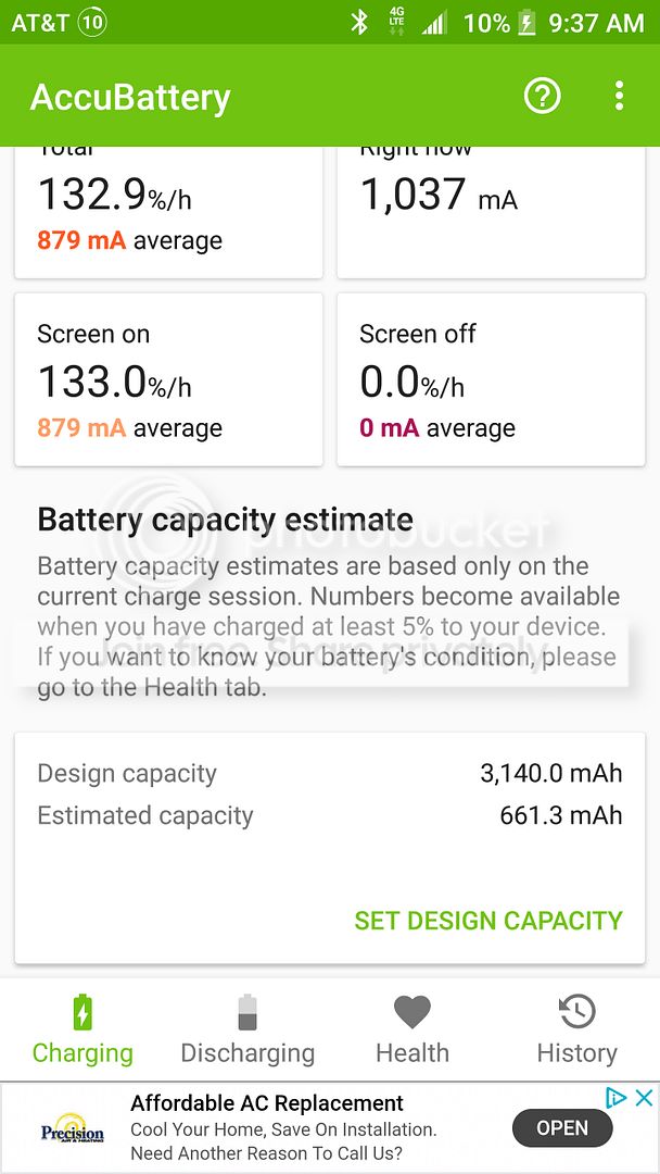

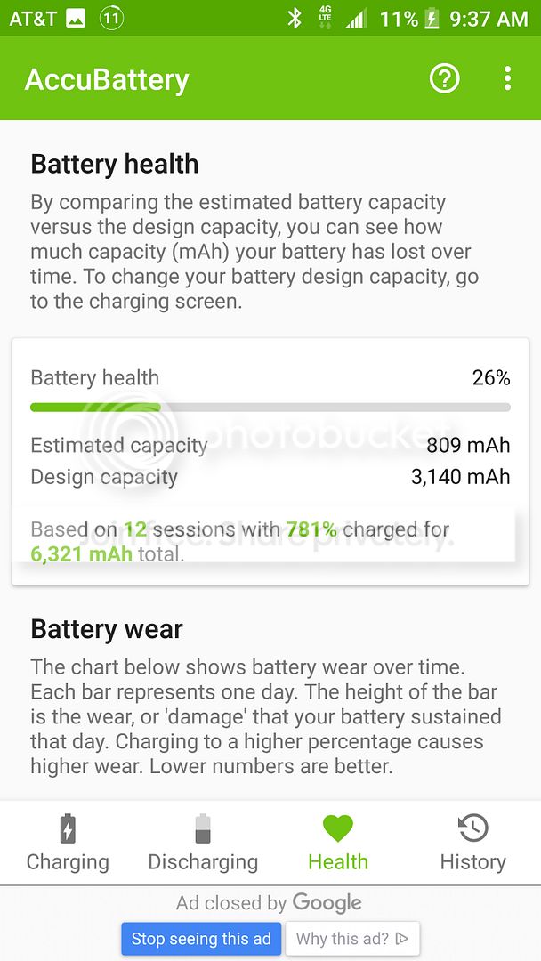

Put in a new battery, this is what accubattery says

Well, the Axon 7 has had just that one initial charge on the new battery and been up for one day and 20 hours. Almost dead now at 7% . Can safely say the battery has helped.
Gotta say though, the S10e has amazing idle efficiency and has been up for one day and 13 hours still at 56%. It has honestly surprised me.
Edit: After taking the A7 off the charger at 6 am , it's still at 89% at 12:36pm (has had use) and normally it would have been around there or lower before I even left the house for work. Be interesting to see how it is after a few charge cycles. I used a low current charge last night.
Will edit again when I get home from work and maybe when I go to bed as that period between home and bed is it's highest use time.
Edit: Well it's 8pm and still at 72%, going well.
Edit: 12:49pm the next day and it's at 38%. This is only relatively light use but a massive improvement over the old battery which looked perfect before I removed it. No swelling etc.
Edit: Got past 2 days from the 2nd charge with light use.
IMO, Daydream killed the original battery. I don't use Daydream anymore but like B04 better than any other ROM despite the hold power button bug and no bootloader unlocking.

Well, time to put this to bed. The new battery is performing to rating as per Accubattery logging it's charge/discharge cycles and my issues with the Axon 7 shutting down early and also dropping percentage prematurely have been resolved. The phone now performs as intended.
No more dual SIM or Daydream use. Will see how this battery lasts. The phone should make it to the right upgrade age now.
gpz1100
Nov 28, 2009
3,053
579
Sadly these new batteries don't last as long as the originals. I replaced mine in feb 2019 and am already starting to see faster discharge with similar use as before. It was great for about the first 6 months.
