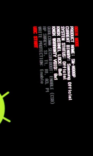

Ok, sounds like software, here is what I would do. Go to micmars here is the link http://forum.xda-developers.com/showthread.php?t=2712205 and get his NC5. Now back up all your data i.e. pics, music, etc. to a ext sd card or PC desktop. Go ahead to do a factory reset. Next with odin on your PC flash a fresh copy of NC5. Now this is the IMPORTANT PART check your download mode screen should look like this :
Both lines at official status, sometimes you end up custom and official, so if not boot into your stock recovery, and use the device keys and do a factory reset again. Then odin flash a fresh copy of NC5 again. I know it seems like a lot of B.S. but I call it taking out the trash, you need to get back to stock square one. Boot it up see if the issues are gone, if so odin flash a recovery here is the link for Philz CWM 6.12.9 hltespr its bulletproof https://goo.im/devs/philz_touch/CWM_Advanced_Edition/hltespr/ then root your device here is the link for SupSu v 1.94 http://download.chainfire.eu/396/SuperSU/ Now if everything is working with no issues, make a backup so you can always restore back to a working OS. Let me know how it goes ?
