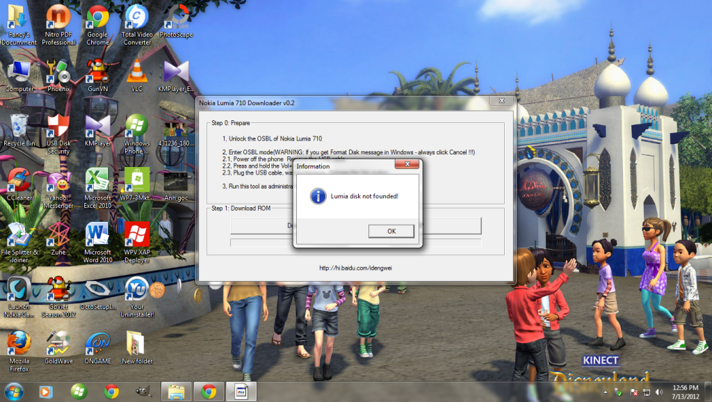

Excuse me, I got a problem.
First of all, when i was trying to flash the qualcomm bootloader, i got this error "Loading hashblock failed with ‘Messenger encountered error ‘Referencia a objeto no establecida como instancia de un objeto.’’". And the process stucked at 50%.
But, It seems to have qualcomm bootloader already, cuz when i plug in the phone, windows asks to format my device and it pops up Qualcomm driver.
So, i try to continue the next step in Ubuntu. But Ubuntu can't detect all partitions...
Before pluging in, i got sda,sda1,sda2
After pluging in, i got this pop-up windows
and sda,sda1 sda2 sda5 sda6 sdb sdc
So, is there anything i can do now? :(

before plugging phone in with linux booted have turned phone off.. wait 5 seconds ... hold volume up and press power --- wait for short buzzz --- now plug usb lead into phone.....
now open DISK UTILITY
it looks like this...
now see how it goes
....".from your picture it looks like you havent pressed vol up while turning device on, thats the only way i could replicate your result anyway...."
(thanx to vova1609 for pic link)
