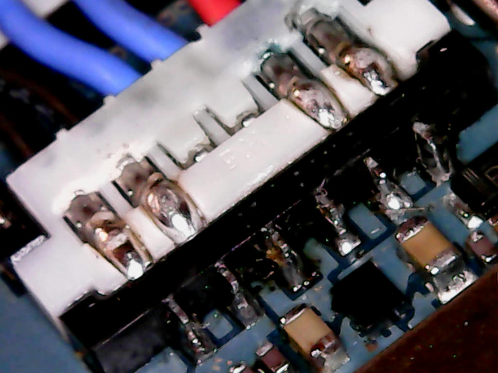

Hello. After some reading and testing of one Samsung SM-T900 I found the same thing as Beut says - cracked soldering on the connector. I resoldered all the pins and now since last 10 hours of testing it it is OK. No restarts, no flickering on the screen.
Posting picture from my microscope of the problem before resoldering.

Dude what happens if you solder two connectors together ? cuz that what the guy who soldered mine did ...
Beut
Jun 28, 2015
531
179
They solder battery cables( 2 positive, 2 negative ) to battery connector on main board to avoid loose connection and to save the cost of new battery.
In case the battery is dead, you have no way to take out the battery without removing the solders. Someone had no idea two connectors are soldered together, damage the connector and main board while removing the battery cables

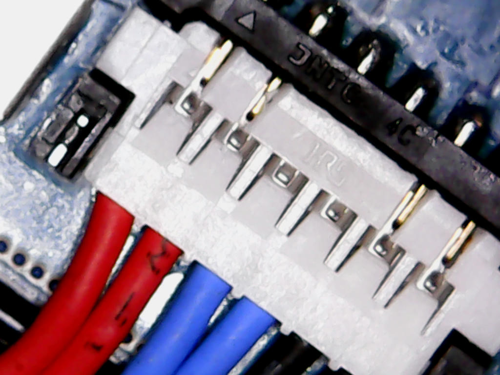

There are two sources causing flickering screen:
1- Cracked battery connector on main board.
2- Battery cables has loose connection to connector on main board.
Repair centers will fix both: re solder battery connector, solder battery cables directly to battery connector on main board.
However, there is no need to solder battery cables directly to battery connector, I fix the loose connection by adjusting the opening of cable closer
Or using Silver Conductive glue, this one is available on Ebay or Amazon, under $5 . However, you have clean up the glue between terminals, otherwise you will experience overheat or low temperature problem due to short circuit.
In this white battery connector, unknown to many users the cables can slightly move right or left, this is when you have intermittent connection
Repair Center fix this issue by soldering directly positive and negative cables to pins of battery connector on main board
They fix the issue of loose connection but average users will face problem of replacing battery as they need to de solder the battery cables.
Then they need to send back to Samsung for a simple repair: replace the battery.

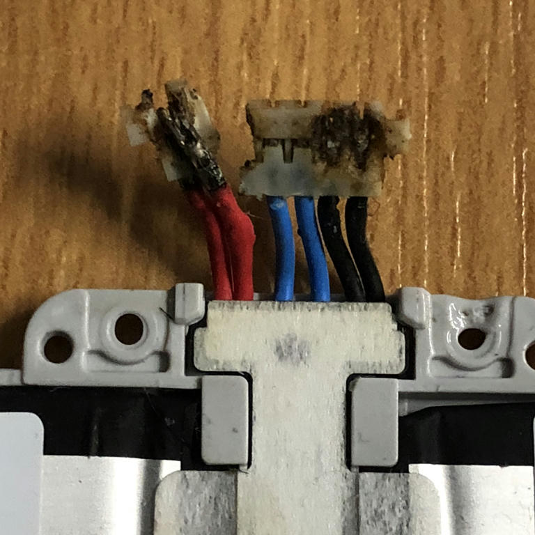

Here is the result when you want to remove the battery, the connector is completely damaged due to the heat
